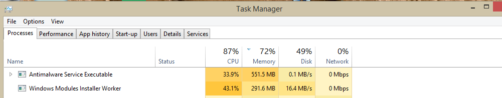

Hello,
I've been having for a few weeks now, two processes hogging everything! Disk is being hogged non stop and its driving me crazy. See below snippet.

    Thank you for posting in Microsoft Community.
    From the description, it appears that there are two services running in the background.
    1. Windows modules installer worker
    2. Antimalware service executable.
    Windows Modules InstallerEnables installation, modification, and removal of Windows updates and optional components. If this service is disabled, you may not be able to install or uninstall Windows updates.
    1. Have you checked if all the updates have installed successfully?
    2. Have you made any changes to the computer prior to the issue?
    3. Have you installed any third party application/ software?
    Let's try few methods and check if it helps:
    Method 1: I would suggest you to run SFC (system File Checker) scan and check if it helps:
    https://support.microsoft.com/en-us/kb/929833/en-us?wa=wsignin1.0
    Method 2: I would suggest you to run the Memory Diagnostic tool and check if it helps:
    1. Press Windows Key + Q and type Windows memory diagnosticand select the tool to run.
    2. If you're prompted for an administrator password or confirmation, type the password or provide confirmation.
    Method 3: I would also suggest you to run Malicious Software Removal Tool.
    You can refer to the Microsoft link to download and run the tool
    http://www.microsoft.com/security/pc-security/malware-removal.aspx
    Note: Any data files that are infected may only be cleaned by deleting the file entirely, which means there is a potential for data loss.
    Method 4: Perform a full scan using Microsoft Safety Scanner and check if helps:
    Refer to this link: http://www.microsoft.com/security/scanner/en-us/default.aspx
    Hope this information is helpful, if not let us know with the updated status and we will be happy to assist you further.

    Thanks,
    I've run all the tasks, and only SFC has reported anything unusual.
    Here is the output:
    PS C:\Windows\system32> sfc /scannow
    Beginning system scan.  This process will take some time.
    Beginning verification phase of system scan.
    Verification 100% complete.
    Windows Resource Protection found corrupt files but was unable to fix some
    of them. Details are included in the CBS.Log windir\Logs\CBS\CBS.log. For
    example C:\Windows\Logs\CBS\CBS.log. Note that logging is currently not
    supported in offline servicing scenarios.

    That looks a lot like the numbers I get in  Windows 10 Task Manager. Is it Windows 10?
    2015-05-07T23:25:26+00:00
    It's 8.1
  5. Anonymous
    2015-05-08T10:05:15+00:00
    Your hard drive may not be in the best of health..
