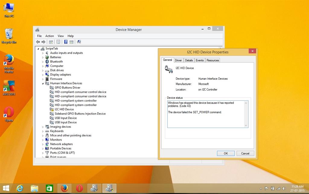

I have a Swipe Ultimate Tablet running windows 8.1
The issue i am facing is that whenever i start my tab from a previous shutdown the touch screen will not work. I have to use my mouse to go to Device Manager option -> Human Interface Device -> I2C HID Device -> disable and again enable the device. This will get the touch screen working till i shutdown again. I have tried the 'Update driver' option and it says "the driver software for your device is up to date". Could someone please provide a solution to this issue.
Also, whenever i do a windows update the touch screen will work for the next 2-3 starts/reboots post a shutdown, after that it will again stop working

    As you are able to fix the issue temporarily by disabling and enabling the touch screen driver, the issue seems to be arising due to corrupted/ unstable touch screen driver and needs to be updated from the manufacturer's website.

    I would suggest you to follow these steps to allow the device to save power.
    a. Press Windows key + X and select Device Manager.
    b. Search for Human Interface devices and expand it.
    c. Right click on the touch screen driver and select Properties.
    d. Select the Power management tab and uncheck the box which says allow the computer to turn off this device to save power.
    e. Click on Ok.
    If the issue still exists, then you might need to install the drivers from the manufacturer's website. The Swipe website does not seem to provide any drivers online. So, you might contact the Swipe support for original drivers for your tablet.
