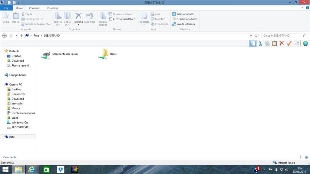

    Are you using a Home Group or a Work Group?  If the latter, is Password Protected sharing On or Off?  Can you access other shared resources from the Windows 8.1 comp (assuming there are any).
    2015-03-29T17:06:20+00:00
    No I'm not using any Home Group or Work Group. It is just in the netowrk (see below : RETE in italian means NETWORK). The printer I'm trying to connect to is the STAMPANTE DEI TESURI.
    Please answer to my questions in my post on March 28. Thanks
    Alex
