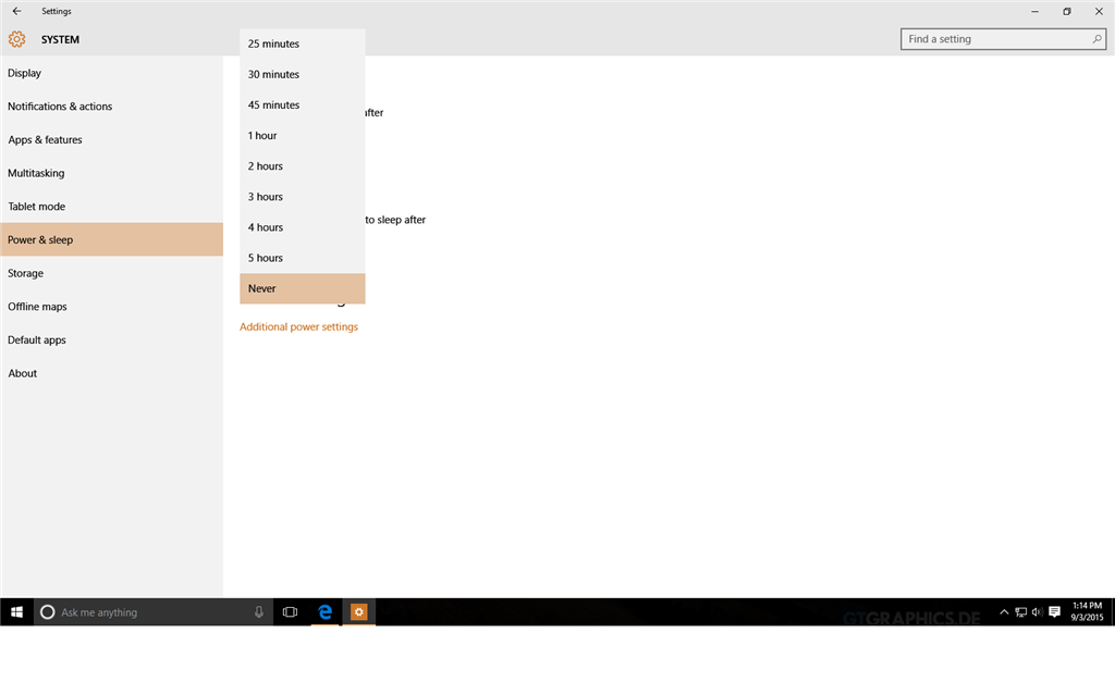

  5. Anonymous
    2015-09-03T12:37:09+00:00
    Change your Power Settings.
    Some of this information might vary slightly depending on which version of Windows you are using. I am using Windows 10 so the steps may differ but the destination will be the same for 8.1 and so on back to XP really.
    Right click anywhere on your desktop. Click on "Personalize"  Click "Lock Screen" scroll down that page until you come to the words "Screen Time Out Settings" and click on that.
    At this stage you should be looking at this:
    Make sure both settings are set to "Never" by using the down arrow on the right.

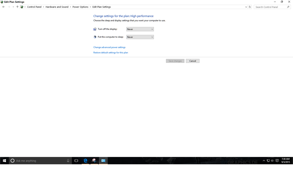

    Alternatively you can go to "Control Panel" "Hardware and Sound" "Power Options" and make the adjustments from there.
    Which will give you this:
