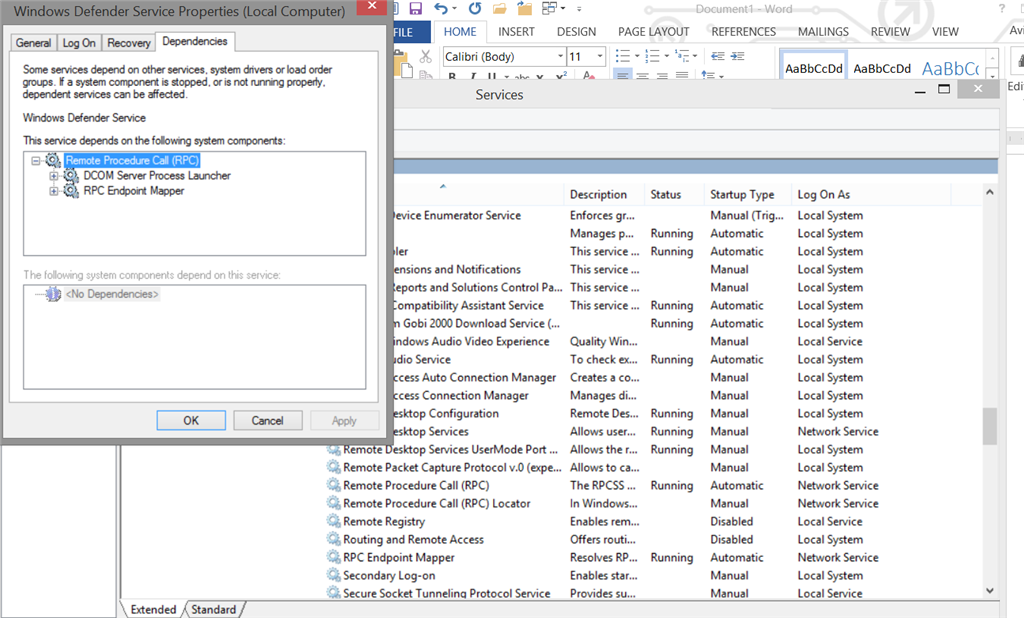

I restored my PC from a System Image in Windows 7 and then upgraded it to Windows 8 and then to Windows 8.1.
All is working fine except for Windows Defender.
When I try to start it I get the message that it cannot be started because it is disabled.
I tried to enable the service via the services.msc in Administrator mode but all the fields are greyed out. The dependencies (RPC) are all running correctly. See the images below.
How can I repair it and get it back to work without a clean install?

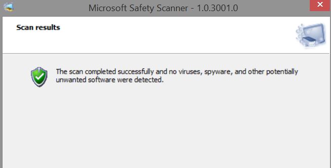

    There is no anti-virus software installed.
    I also downloaded and executed Msert. The PC is clean:
    Where do we go from here?
