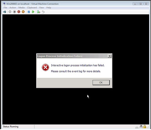

Recently my Win 7 (pro 64bit) computer does not start-up properly and stops with the following warning on a black screen:
"Interactive logon process initialization has failed.
Please consult the event log for more details."

    You are seeing this screen, right:
    You will not be booting in any mode with that error.

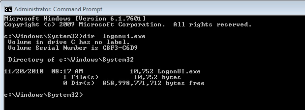

    It that is the case, assuming Windows is installed in the Windows folder on your C drive see if the following file is present or is it missing:
    c:\windows\system32\logonui.exe
    Or from your System Recovery Options choose Command Prompt to open a Command Prompt window and see if the logonui.exe file is present or is it missing by entering this command:
    dir  logonui.exe

    Hi ElderN,
    That is indeed the screen I get when boot-up is failing. I used the recovery CD to access the disk using the command prompt. I had checked that option already. Both winLogon.exe and LogonUI.exe are present in windows\system32.
    Thanks,
    Dick Bos
