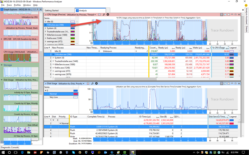

    Tiworker relaunches itself as needed.  Check to see if it is running.
    As you can see from the snip, when you ran the trace your disk was not even close to being 100%.  If you are still experiencing the problem and you are sure TiWorker is off (and stays off) re-run the trace and upload it

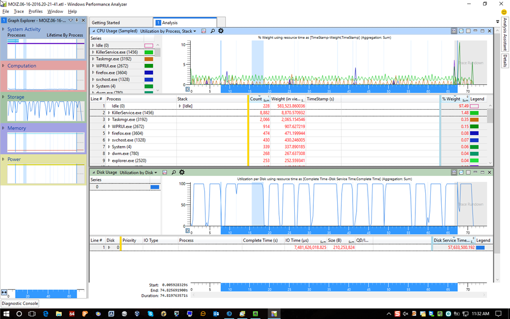

    I/O error may be the cause of everything.  Please run these two tests
    To test a suspect HD You should do 2 things as described in this wiki
    http://answers.microsoft.com/en-us/windows/wiki/windows_10-hardware/hd-checking-how-to-test-yours/588b34ee-211b-4747-9a92-ee106090cbbf?tm=1447383116605
    In this trace the CPU was almost inactive but the HD was thrashing.  The I/O error is probably the cause

    Does not appear to be a disk problem.  It does appear that Tiworker.exe is causing some severe CPU issues.  Tiworker is related to windows update.  If you kill Tiworker in task manager does the CPU use (and HD use) get better?
    Were you experiencing the high HD activity when the trace was run?
    I would also run a system file check to find the state of the OS
    Please run a system file check (SFC) & DISM  if you are on win 8 or higher
