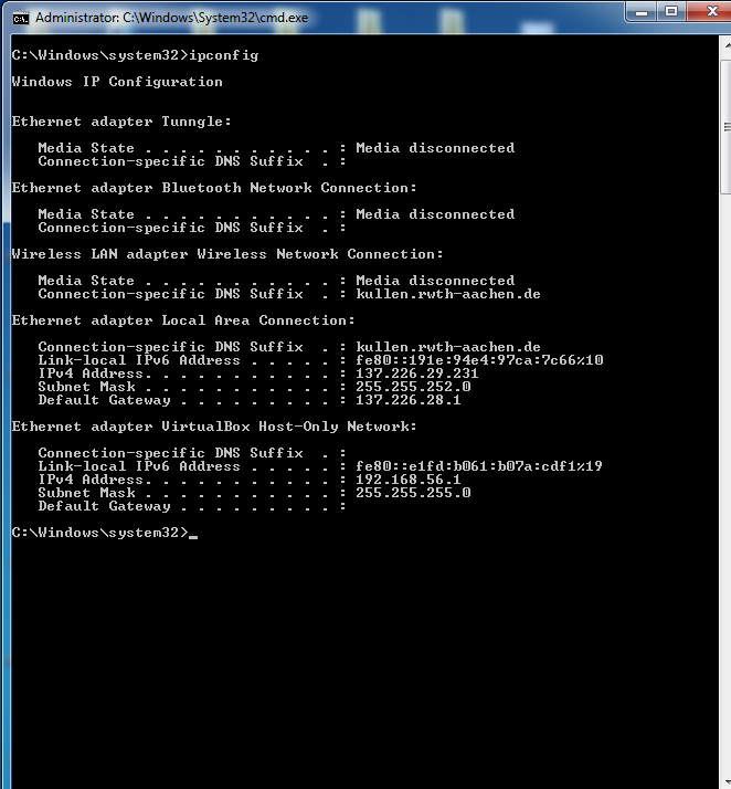

    2016-10-21T18:46:57+00:00
    About what Frederik asked (on my laptop):
  5. Anonymous
    2016-10-21T20:15:30+00:00
    Since you are in a student dormitory you can use the following instructions for testing purposes only. The result will tell you if the hardware (network adapter, CAT5 cable, switch port) are intact.
    1. Open the Control Panel / Network and Sharing Center.
    2. Double-click "Change adapter settings", then double-click your Ethernet adapter.
    3. Click "Properties".
    4. Untick the IPv6 protocol.
    5. Double-click the IPv4 protocol.
    6. Mark "Use the following IP address" and enter these numbers:
    IP address: 137.226.29.253
    Subnet mask: 255.255.252.0
    Default gateway: 137.226.28.1 7. Click OK. 8. Open a Command Prompt with cmd.exe. 9. Type this command and press Enter:
    ping 137.226.28.1
    Report the result. 10. Return to the panel where you set the IP addresses, then mark "Obtain an IP address automatically". If you skip this step then you are likely to cause a conflict of IP addresses with other machines in the dormitory.
