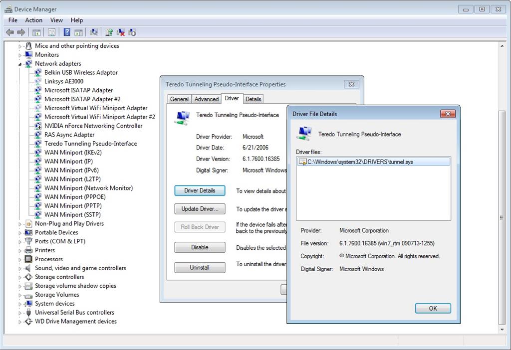

    The Teredo adapter should use the tunnel.sys driver that comes installed on every system and has nothing to do with printers:

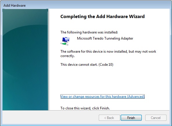

    Assuming you are following some directions to add the Teredo maybe you are seeing something like this after installing:

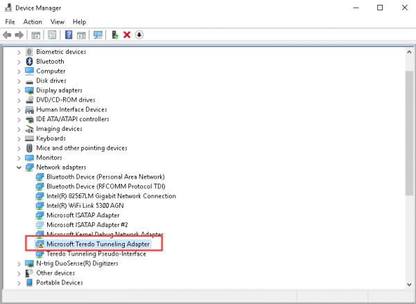

    And Device Manager shows a yellow exclamation next to the Adapter like this:

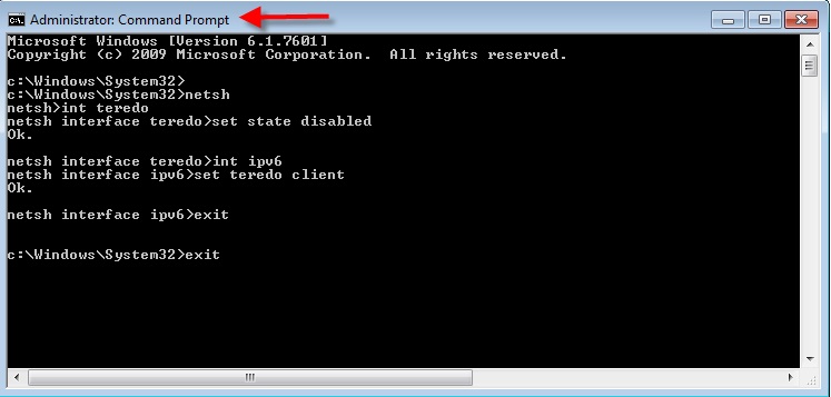

    In the Command Prompt window enter the following commands one at a time pressing the Enter key after each:
    • netsh
    • int  teredo
    • set  state  disabled
    • int  ipv6
    • set  teredo  client
    • exit
    You should be seeing something like this as you enter the commands one at a time:
    Close the Command Prompt window by entering exit one more time.
