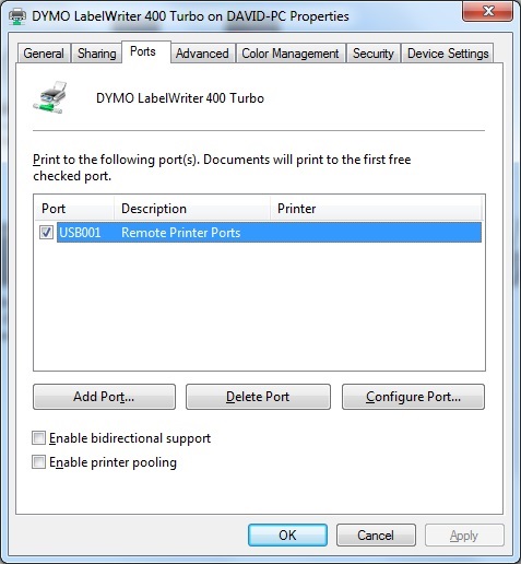

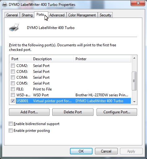

    Here are the screen shots of the Printer Ports Tab for the Dymo Printer from both the Server Computer (David-PC) and a Client Computer (XR1).
    Server (David-PC)
    Below is the Printer Port Properties from a Client PC (XR1) using this printer share from the Server (David-PC).
    'Enable bidirectional support' unchecked on both systems.  This setting has no bearing on the lost driver, but unchecking this setting removes a printing delay that has been experienced on other occasions.

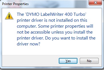

    Here is the screen shot of the 'Driver Missing' error that is displayed when right clicking the Printer Object and selecting Properties.
    As mentioned earlier, to make this go away and restore Label Printing on the Server PC, all that needs to be done is to Stop Sharing the Printer, and Reboot the Server PC.
    Once the Server-PC has been restarted, Label Printing is restored, and there are no 'Missing Printer Driver' messages when right clicking the Printer Object and selecting Properties.
