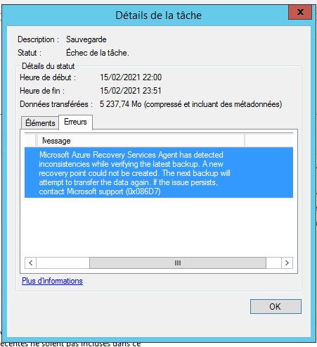

I have 3 servers with MARS and on one i have this problem for 4 days
"Microsoft Azure Recovery Services Agent has detected inconsistencies while verifying the latest backup. A new recovery point could not be created."
Impossible to backup

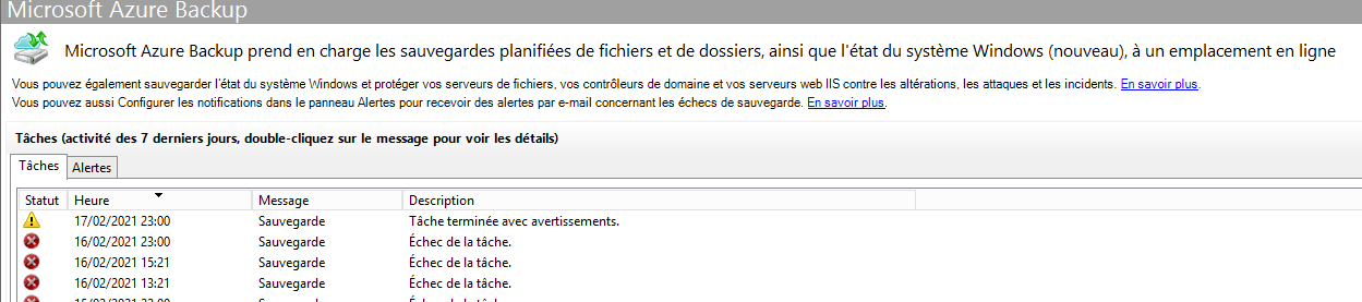

    Bonjour,
    La mise à jour a corrigé mon problème et j'ai également dû changer le passphrase.
    Dans le Microsoft Azure Backup à droite tu as "Modifier les propriétés". Le premier onglet "Chiffrement" permet de la modifier.
    Il faudra que tu accèdes à ton portail azure pour générer un Code PIN afin de la valider.

    Hello,
    I have update MARS 2.0.9200.0 to 2.0.9205.0
    now the backup don't failed but i have this warning
    And ton find how validate the passphrase.
    I see on community i must stop console and when i restart her i can see message to validate passphrase, but not in my case :/
    where i can validate the passphrase ?
