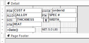

I am using the following code along with a report to generate shipping labels based on a Work Order number, autonumber field.
The labels are placed on each unit, and the units are placed in a box, 10 units per box. How can I alter my code so that the labels are numbered 1-10 in sequence? There are 30 labels per sheet, so each column would need to be labeled 1-10, with 3 columns/boxes per sheet...
