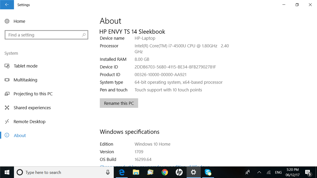

After I recently installed windows 10 upgrade Version 1709 I am getting the Error Message : Stop Code Video Management Internal.
I Have been running Windows 10 on my HP Envy  TS 14 for some time without any problems, but now this.
Below are the details of my system.
I have downloaded and installed the latest drivers for the Intel and Geforce video cards.
How can I resolve this.
Cheers,
Rudi
