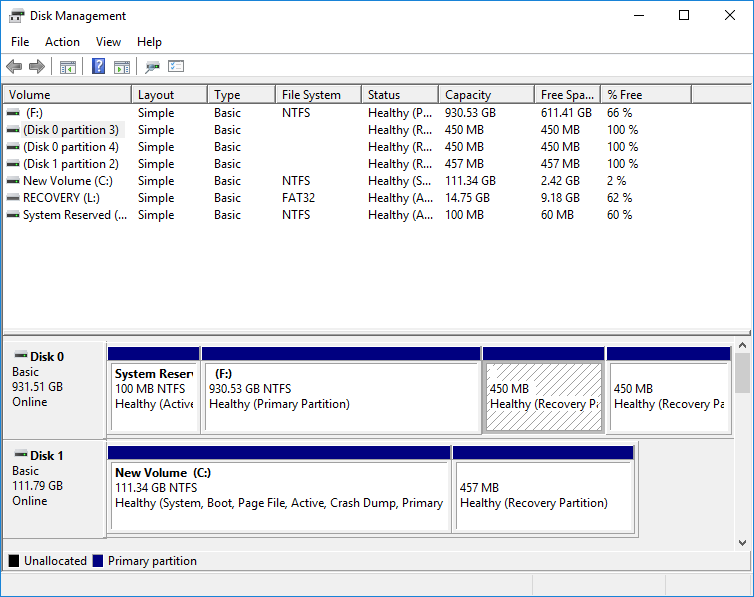

I have dual boot windows 10 SSD/ HDD
After updating the HDD it restarted right into check disk ran for hours so i restarted,
HDD wouldnt load (forgot error), HDD access was denied in my SSD so i swapped the drive letter now i can view all HDD contents in my SSD but when i boot into HDD it now says Bootmgr is missing, looking into other fixes i found out there is two partitions and the windows  folder is empty?!?
Im wondering if the checkdisk utility made two new partitions and moved the windows contents.
To conclude: I can boot into SSD fine and view HDD files but cannot boot into HDD as the BOOTmgr error shows.
Disk 0 is the one not booting, im worried the system files are in the two other partitions?

    These do not work these are the first things i tried , these does not appear to be a corrupt boot problem, this problems seem to be with the partitions.
    2018-03-23T18:38:52+00:00
    Thanks ill give that a try, when trying through CMD it will say access is denied and can not find another windows instillation, i think from the windows folder being empty?

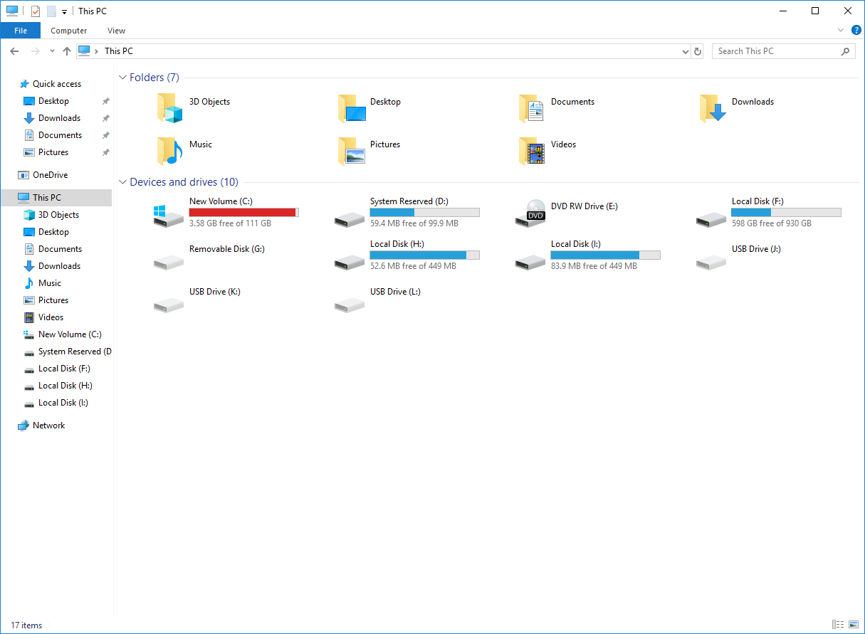

    I unhide the two new recovery partitions and found some folders inside i believe this to be created by either windows 10 update or by checkdisk
    I think the windows contents are in these "recovery directories"
    F: is the dirve H and I are the new partitions in the drive
