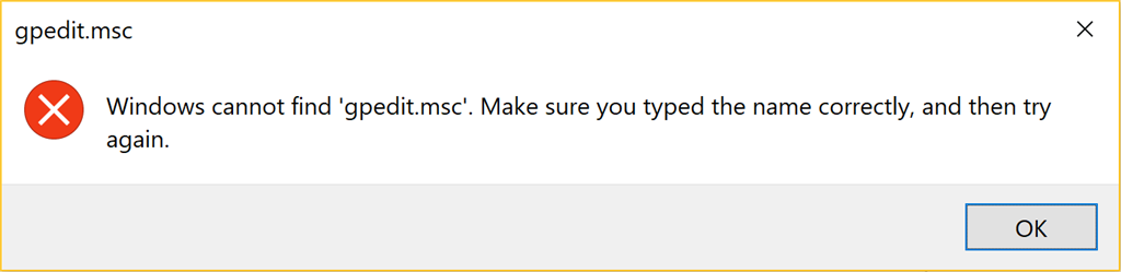

    2017-11-04T15:09:26+00:00
    thank you for your reply
    1- yes i can access user files when i go through users, I can even access the public folder that way, however when I go through the network, it wont work, as described in my initial post.
    2- this is interesting, I just realized i dont have group policy on my windows, or cant access it, i tried running gpedit.msc, but windows cant find it (see image below), i tried going through windows search, through command prompt, didnt work
    I hope this helps in diagnosing the problem

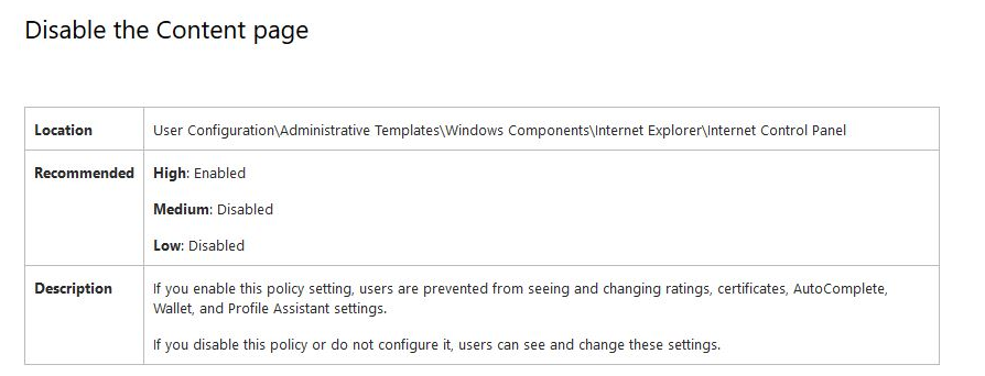

    2017-11-03T19:42:49+00:00
    Thank you for your response. Have you tried accessing the local files using this format (?): file:///C:/Users/username/Downloads/
    Please check this under the Group Policy settings. Check the photo below:
    Regards.

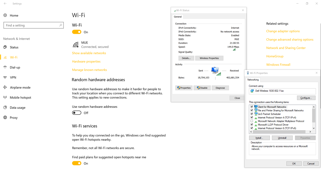

    2017-11-01T09:20:37+00:00
    Thank you Leviozar
    Im not sure what do you mean by ethernet properties, since I dont have an ethernet port on my laptop, heres a screenshot of the wifi port properties though
    (all other items under wifi properties below IPv6 are enabled)
    SMB1.0/ CIFS File sharing support is ticked (enabled)
    I tried the IE workaround in this user and in another user account, while disabling firewall and antivirus, did not help, I couldnt access the web though, until I restored IE settings
    awaiting your feedback
