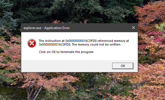

    This post, I was able to include the actual screen from the error.

    Greg - please keep in mind, I am trying to find what this "unknown kernel error" is.. may be hardware related?  Since 1984.. MS shouldn't have any error codes that start off with "unknown".  Drivers must be WHQL certified for me to use them, so that error code has to be related to something we can put a finger on...or at least in a category, set aside by the developers to say "yeah, that would be related to such and such".
    If not.. not even a fresh install (will be avoided at all costs due to 50+ programs installed) will cure it, because the hardware and driver versions won't change.  I use ISOs to install upgrades, as I have options with them I do not have with Windows Update..choosing "new install, keep files" vs. "wipe the drive, install Windows".
    Again.. much information to go thru, and continue to check off, seeing as I've done at least four/ five of the steps.  If it's a memory read error, and after adjusting the pagefile, I will run a complete RAM and HDD test.
