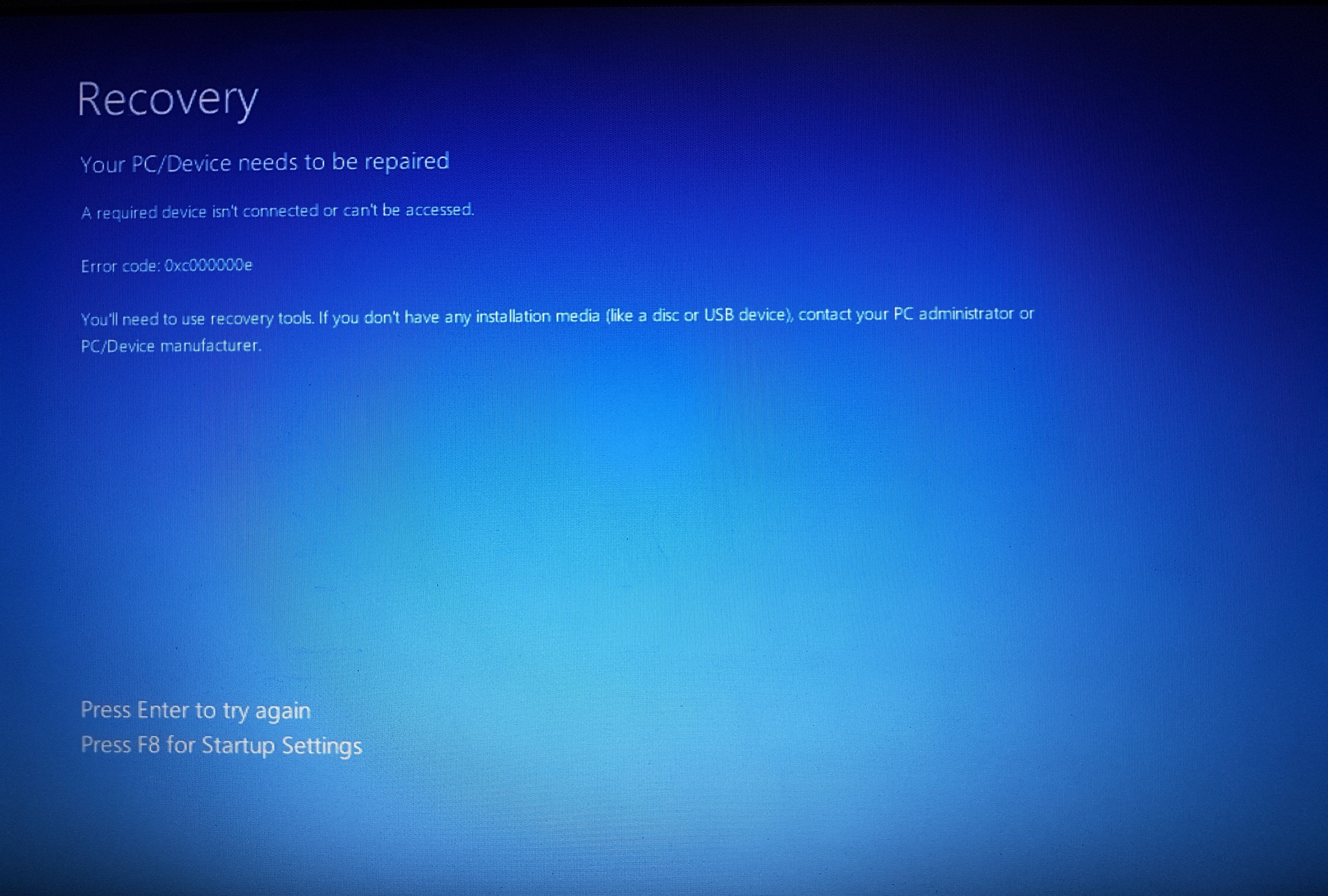

Leading up to this my computer began slowing down where there was little to none responsiveness, so I had to manually shut it down because there wasn't really much I could do on it. During the slow responses I had tried to download an antivirus software (AVG Antivirus) and managed to do so and scanned but during the middle of scans it would stop and not do anything, and since it wasn't doing anything I shut it down again. Now when I tried to start it up again today I was greeted with this message and "Error code: 0xc000000e" immediately after the manufacture logo. I tried searching for a solution for this problem and found some solutions others had shared and tried them myself but had no success myself as I've tried what solution that thisperson gave to had a similar problem but no success as up till the part where Bootrec /fixbootis needed to be typed into command prompt it says "element not found" in response and from then out I haven't been able to do anything since, I'm looking for a solution that wouldn't result in any data loss as I have some files I don't want to loose.

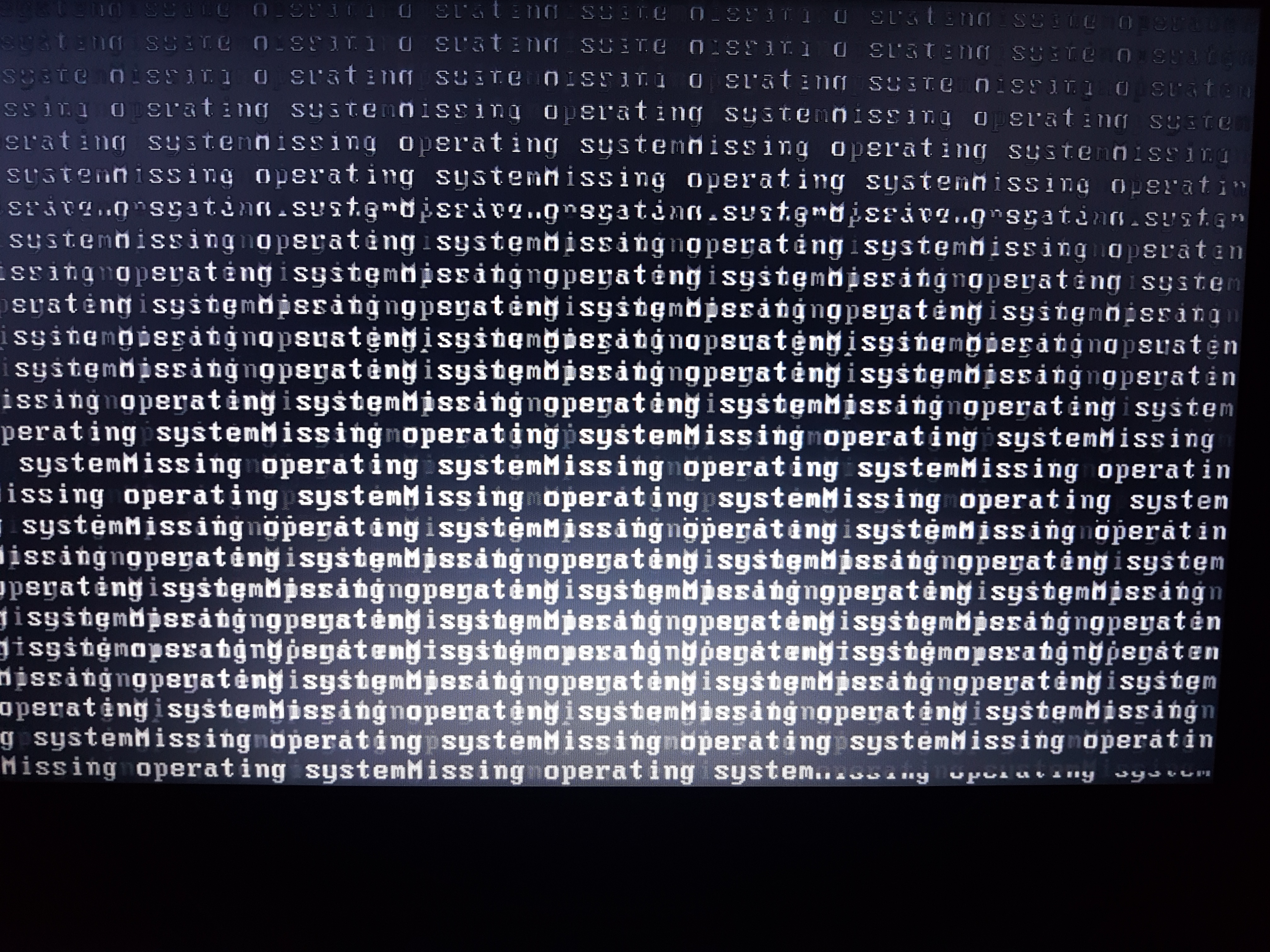

    So update, the custom install didn't work and so I decided that I'd just follow through with a clean install this way
    And now this happened :-
    It's literally a screen of the same sort of repeated phrase running down across my screen.
  2. DaveM121 891.6K Reputation points Independent Advisor
    2018-04-26T12:00:22+00:00
    Hi Bradison, try all the options in the Windows Recovery Environment, none of these options will result in data loss or require a Product Key
    Start your PC, just as Windows attempts to load (spinning dots), press and hold Power Button for 5 - 10 seconds to perform a Hard Shut Down
    Do this twice
    On the third start Windows will boot into the Recovery Environment and from there you can access System Repair, Safe Mode, Command Prompt . . . etc.
    Please try each option one at a time, then see of Windows will boot . . .
    Go to Troubleshoot - Advanced Option - Startup Repair
    See if Windows startup can repair itself
    Go to Troubleshoot - Advanced Option - System Restore
    Check to see if you have a restore point you can go back to
    If you do not have a Restore Point, go to Troubleshoot - Advanced Option - Startup Settings and click Restart
    Upon restart, press 4 to enter Safe Mode
    Once in Safe Mode, backup your data if you do not already have a backup
    Open Device Manager and check to make sure all your Drivers are up to date
    Reboot to see if Windows will start Normally
    If the above fails, go to Troubleshoot - Advanced Options - Reset this PC
    Choose to keep your files and apps
    Then start the Reset

    You should perform a custom install if your don't want to lose your data.
    Go to a working computer, download, create a bootable copy, then perform a clean install.
    	Step 1: How to download official Windows 10 ISO files
    	[http://answers.microsoft.com/en-us/windows/wiki...](http://answers.microsoft.com/en-us/windows/wiki/windows_10-windows_install/how-to-download-official-windows-10-iso-files/35cde7ec-5b6f-481c-a02d-dadf465df326)
    	Step 2:
    If there are files on the drive you want to recover, see -  How to: Perform a Custom install of Windows 10
    http://answers.microsoft.com/en-us/insider/wiki...
    or
    Power on and off your computer three times
    On the third time, your computer will boot into the Advanced Recovery environment
    Click Advanced Options
    Click Troubleshoot
    Click Reset this PC
    Click Keep my files
    Choose your account
    Enter your password
    Click Continue
    Click Reset
