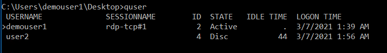

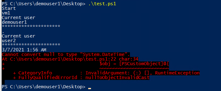

    Thanks @shiva patpi for your script. I have tried to execute the script but got some issue . After some debugging , i have updated param & begin section as it was not able to execute and target is to run to run VM only. But with below script its able to terminate session which are idle for sometime but throws error when system is having disconnected user.
    Hope you can help with below error .
    I am getting below error
    Output of quser in system as below
    Powershell script I have updated to

  3. shiva patpi 13,376 Reputation points Microsoft Employee Moderator
    2021-03-08T06:12:13.18+00:00
    @Baharul Islam ,
    If you want to logoff the disconnected users , we might have to rely on query session property.
    The script mentioned here http://blog.kuppens-switsers.net/it/close-disconnected-remote-sessions-using-powershell/ will logoff all the disconnected users.
    If we want to logoff users with "In Active Idle Session" , then you will have to combine both the script and customize it accordingly based upon your requirement.

    (I just tested it for both disconnected and Idle active sessions and it works)
    Let me know if that above script works for you. Make sure to "Upvote and Accept the answer"
