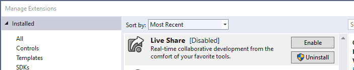

  2. Dylan Zhu-MSFT 6,431 Reputation points
    2021-03-02T07:40:39.113+00:00
    Hi mderj,
    You can try to disable live share extension, then restart visual studio.
    Best Regards, Dylan
