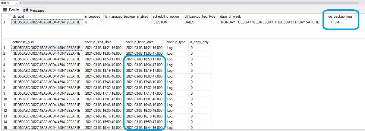

Configuring managed backups schedule at 5 minutes intervals for transaction log backup is not honored. The feature backup the log at 10 minutes intervals instead of 5.
I've attached a screenshot with an example.
"managedbackup.fnbackupdbconfig" shows it is configured at 5 minutes intervals but when querying msdb for backup history, the log are being taken at 10 minutes intervals.
I've also restored one of the affected database to make sure that the log chain was not somehow broken and confirms that nothing else occurred between two log backups.

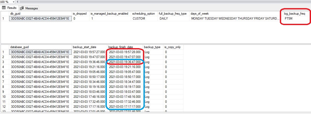

    I've already did it in my initial attempt (reconfiguring) but as requested, I reproduced the issue with new screenshots.
    I've configured managed backup to initially take log at 15 minutes frequency (which it did correctly) than I switch to 5 minutes frequency and the log were then being taken at 10 minutes frequency. I also point out where SQL shows the configured interval to demonstrate it was indeed configured at 5 minutes frequency.

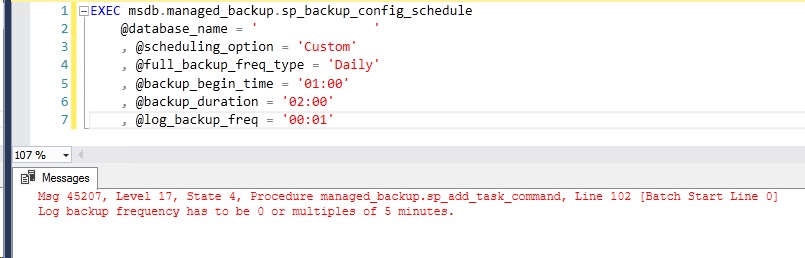

    yes I've already read the documentation and to show you I did, I will pinpoint you a misleading information with the way managed backup schedule works.
    The documentation says it can be configured at the minute, but when the command is run, SQL prompt an error telling 5 minutes is the lowest possible frequency and needs to be configured using a multiple of 5 minutes.
    This determines the frequency of transaction log backups. These backups happen at regular intervals rather than on the schedule specified for the database backups. @Loughborough _backup_freq can be in minutes or hours and 0:00 is valid, which indicates no log backups. Disabling log backups would only be appropriate for databases with a simple recovery model*

    It seems the Log Backup frequency can be set to a multiples of 5 minutes but it cannot be implemented at 5, even if you specify 5 for @Loughborough _backup_freq.
