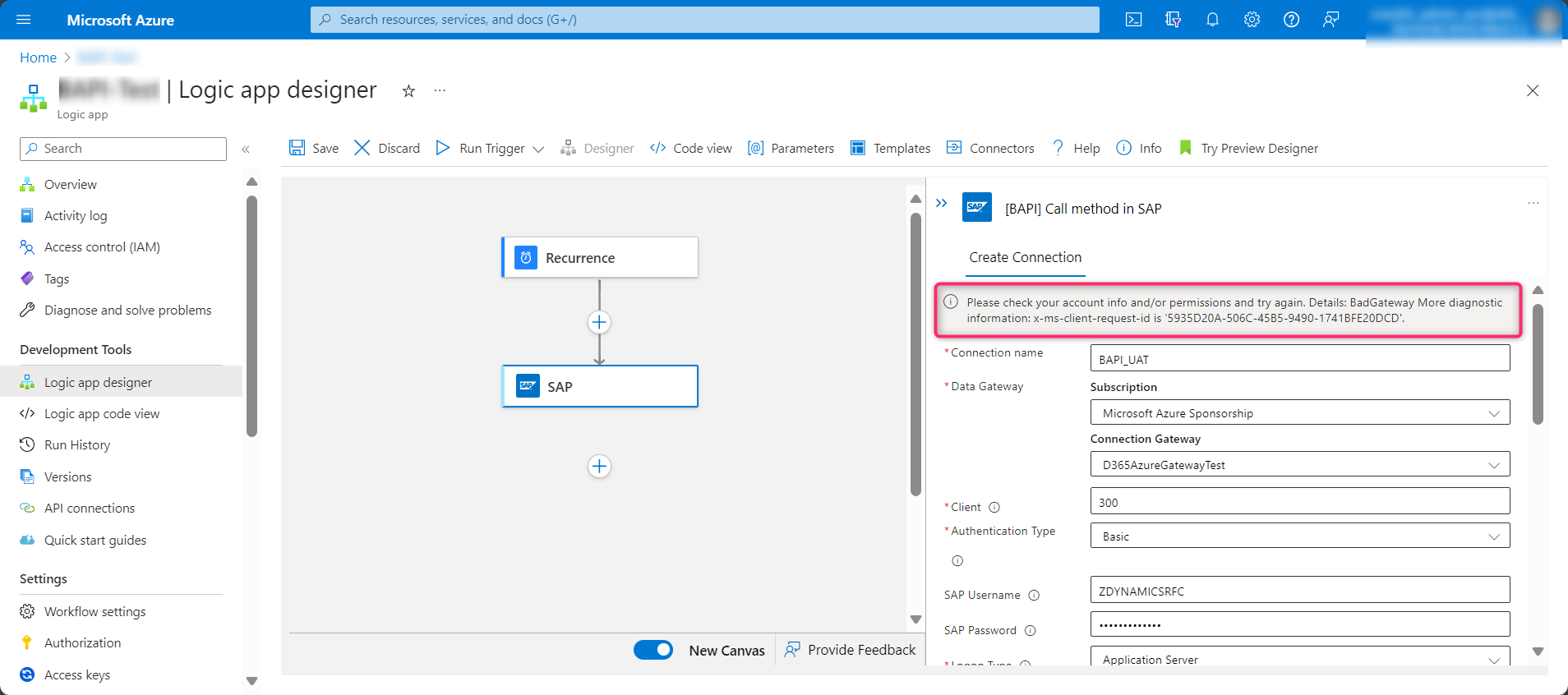

I have a problem connecting the on-premises data getaway with my logic app
The gateway is setup correctly considering the status (a screenshot below)
When trying to use the SAP send message, I'm constantly receiving this error message (screenshot below):
(this gateway is the correct one, there is just something wrong with naming)

The error message is:
Please check your account info and/or permissions and try again. Details: Failed to process request. Error details: 'Could not load file or assembly 'sapnco, Version=3.0.0.42, Culture=neutral, PublicKeyToken=50436dca5c7f7d23' or one of its dependencies. The system cannot find the file specified.'. More diagnostic information: x-ms-client-request-id is 'CE4B56F1-297B-42FF-98D6-AF1C83098F92'.

    I have looked into backend logs and I can see the error coming from the gateway service.
    Please review the SAP compatibility and SAP client library prerequisites. As mentioned in the document you need to install SAP .NET Connector (NCo) library. Looks like this is missing, please install the SAP driver from here and then restart the machine as well as the on-premises data gateway.
