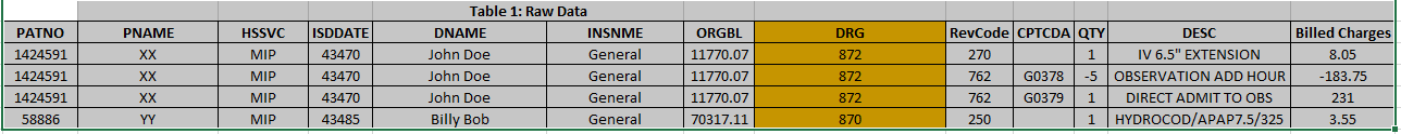

I have this data set with patient information/charges (Table 1).

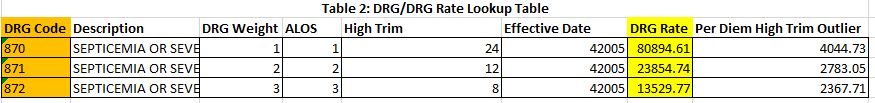

  3. DRG Rate from Table 2. This is just matching the DRG in Table 1 to Table 2 and getting the DRG Rate Associated with it.

Note, each patient has only ONE claim, but can have multiple line items as shown in table 1.
Table 1: Raw Data
Table 2:
