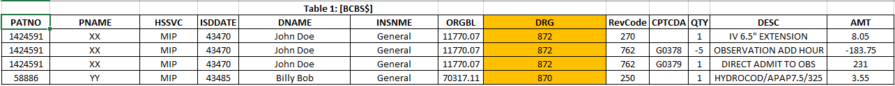

I have this data set with patient information/charges [BCBS$]
I am looking to achieve Table 3. Table 3 shown below has:
  1. Distinct Patient Number (Patno)
  2. The sum of Billed Charges for each Patno (sum billed charges then group by patno)

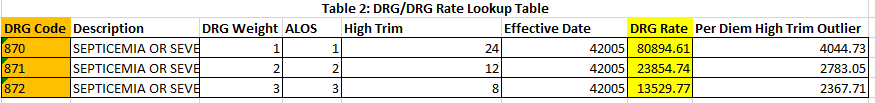

  3. DRG Rate from Table 2. This is just matching the DRG in Table 1 to Table 2 and getting the DRG Rate Associated with it.
  4. Stop loss column. If the sum of Billed Charges for a patient (found in column 2) is >275000 then (SUM of Billed Charges -275000)*.195+ DRG Rate from column 3
  5. Claim total: If there is a stop loss, then the claim total is just = to the stop loss value found in column 4. ELSE, it is equal to the DRG rate.
Note, each patient has only ONE claim, but can have multiple line items as shown in table 1.
Table 1: [BCBS$]
Table 2: [BCDRG]
Table 3: Desired Output

SELECT PATNO, SUM([AMT]) as AMT,
(SELECT [DRG Rate] FROM [BCDRG] WHERE [DRG Code]=[BCBS$].[drg]) AS DRG_Rate,
CASE WHEN SUM([AMT]) >275000 THEN ((SUM([AMT])-275000 )*.195)+DR.[DRG Rate] ELSE 'NO' END AS StopLoss,
CASE WHEN SUM([AMT]) >275000 THEN ((SUM([AMT])-275000 )*.195)+DR.[DRG Rate] ELSE DR.[DRG Rate] END AS ClaimTotal
FROM [BCBS$] AS RD
INNER JOIN [BCDRG] AS DR ON RD.DRG=DR.[DRG Code]
GROUP BY PATNO
