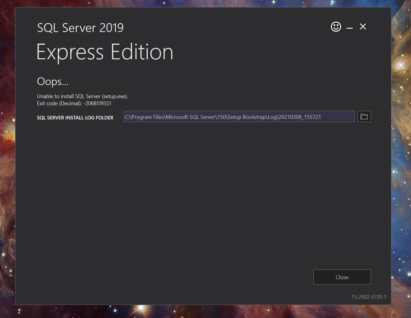

Hello,
I was trying to install the basic version of SQL Server 2019 but accidentally downloaded it to the wrong disk. I wanted to uninstall and reinstall it but I faced an error. I followed the instructions from the posts below (linked):
https://social.msdn.microsoft.com/Forums/en-US/8e1cea03-650d-447c-b4cb-7eba377d4fca/sql-server-2017-installation-error?forum=sqlexpress
https://social.msdn.microsoft.com/Forums/sqlserver/en-US/2c04b654-107a-46ce-98a9-aa64068c6e28/sql-express-2017-installation-failed?forum=sqlsetupandupgrade
But I still have an error stating that; Exit code (Decimal): -2068052377 Screenshot is below. I'm using Windows 10.
Am I missing something? What should I do?

  2. Nuray Nasib 1 Reputation point
    2021-03-08T12:46:15.007+00:00
    I followed these instructions;
    1. Go to "Control Panel\Programs\Programs and Features" to remove SQL Server and their components.
    2. Back up the registry.
    3. Delete the following keys in regedit:
      --HKEY_LOCAL_MACHINE\SOFTWARE\Microsoft\Microsoft SQL Server
      --HKEY_LOCAL_MACHINE\SOFTWARE\Microsoft\MSSQLServer
    4. Go to "HKEY_LOCAL_MACHINE\SOFTWARE\Microsoft\Windows\CurrentVersion\Uninstall" to delete all the sub-keys referencing SQL Server
    5. Go to "HKEY_LOCAL_MACHINE\SYSTEM\CurrentControlSet\Services" to delete all the keys referencing SQL Server
    6. Remove all the SQL Server folders in your machine.
    7. Reboot your machine.
    And I'm still getting the error below;
    I don't understand what "install it with a instance name different from the old installation" means. Can you be more open?
  3. Erland Sommarskog 129.1K Reputation points MVP Volunteer Moderator
    2021-03-08T22:04:33.987+00:00
    If you look closely at your screenshots, you will see that you get different error codes. Whether this is progress or not, I don't know. But look in the folder listed in the screenshot. You can start with Summary.txt. Usually the real error is in detail.txt, but that is a very verbose file.
