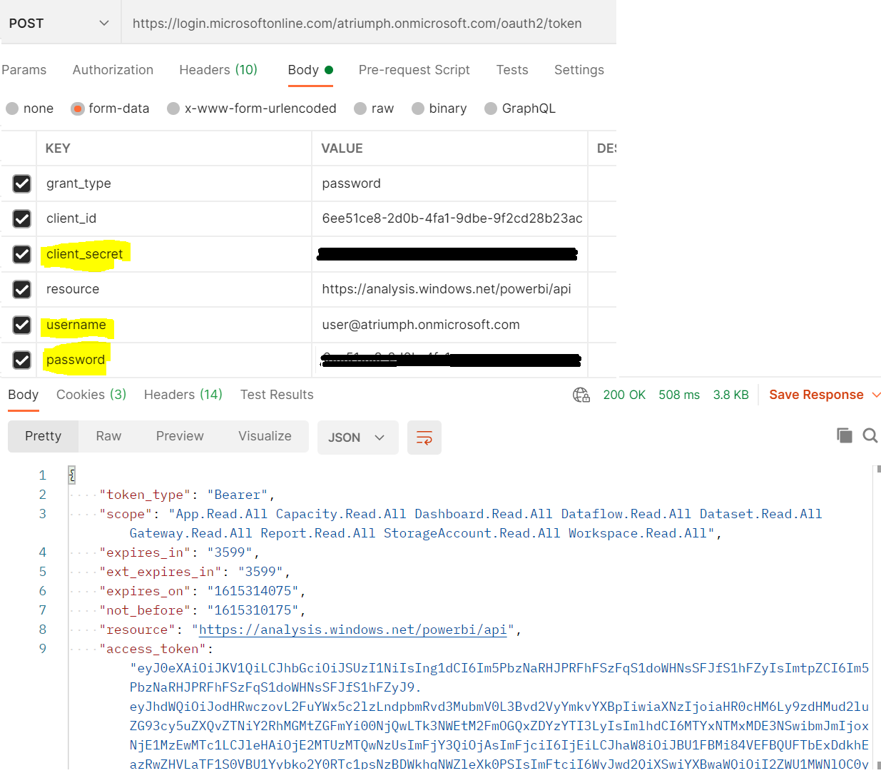

  2. Siva-kumar-selvaraj 15,731 Reputation points Volunteer Moderator
    2021-03-09T17:29:24.417+00:00
    Hello @Ad-K ,
    Thanks for reaching out.
    I had tried above steps and was able to generate token successfully. Here is outcome from Postman.
    Looking at above error message AADSTS50126, which indicate invalid username or password also I see that you had verified your email and password several times, just wondering did you try to access azure portal with same credential successfully?
    These are possible causes I could think of:
    • Can you verify if Content-Type mentioned as application/x-www-form-urlencoded in PostMan header , because when UPN or Password contains special characters then using urlencoded make sure values are being translated with right format.
    • When you say email address, is that same as UPN? because username key-value must be UPN (User principal Name) not email address, ignore this step if UPN and email address both are same.
    Hope this helps
    Do let us know if this helps and if there are any more queries around this, please do let us know so that we can help you further. Also, please do not forget to accept the response as an Answer; if the above response helped in answering your query.

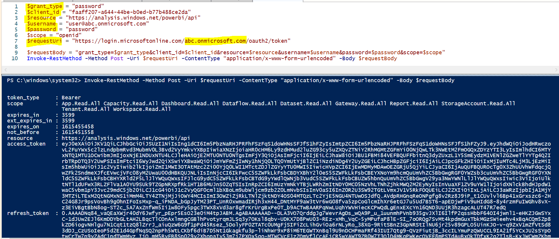

  3. Siva-kumar-selvaraj 15,731 Reputation points Volunteer Moderator
    2021-03-11T08:57:51.283+00:00
    Thanks for the confirmation.
    Could you please try with PowerShell way and see if that helps? just replace with your own values which are highlight in yellow as shown below:
    PowerShell outcome from my lab:
    PowerShell cmdlet
    Replace with your own values
    $grant_type = "password"
    $client_id = "faaff207-1111-44be-1111-b77b488ce2da"
    $resource = "https://analysis.windows.net/powerbi/api"
    $username = "******@abc.onmicrosoft.com"
    $password = "password"
    $scope = "openid"
    $requestUri = "https://login.microsoftonline.com/abc.onmicrosoft.com/oauth2/token"
    Then execute these cmdlet
    $requestBody = “grant_type=$grant_type&client_id=$client_id&resource=$resource&username=$username&password=$password&scope=$scope”
    Invoke-RestMethod -Method Post -Uri $requestUri -ContentType “application/x-www-form-urlencoded” -Body $requestBody
    if PowerShell doesn't work, then can you try with different username and password ?
