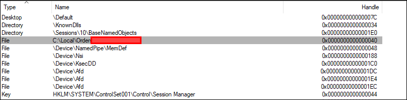

Hi, I am trying to obtain details of a running process. I have access to the process, I mean by that I can get the process object no problem.
I would like to find details like ProcessExplorer is able to display.
It's this line "File" with a local path that I would like to be able to read. Any idea of how this can be done?
Developer technologies | VB
  1. Castorix31 91,506 Reputation points
    2021-03-08T16:06:09.83+00:00
    The screencopy you posted is the list of Handles of a Process
    This is done with NtQuerySystemInformation and SystemExtendedHandleInformation flag
    I had posted a test in C# : GetHandlesFromPID in this thread
    You can convert it into VB with tools like https://converter.telerik.com/
