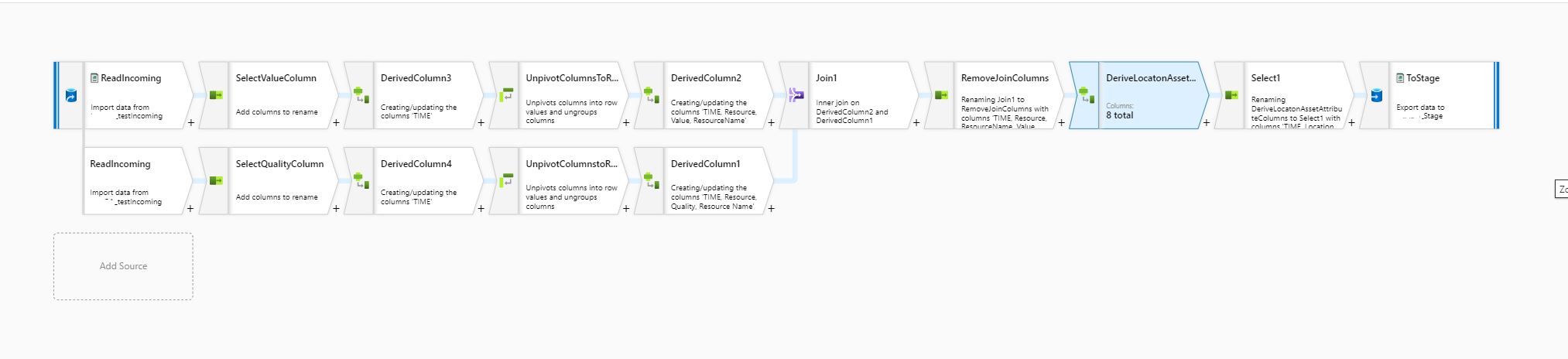

Working through parsing data in Synapse using data flows. Here is my data flow thus far :

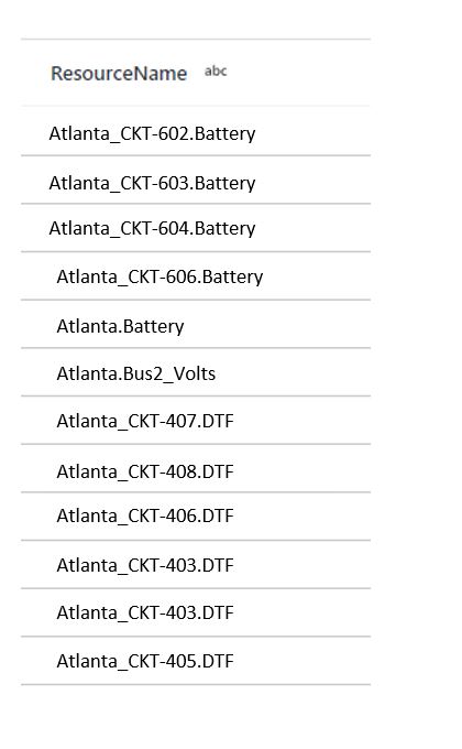

Here is a sample of the data prior to using a derived column to parse through each of the records:

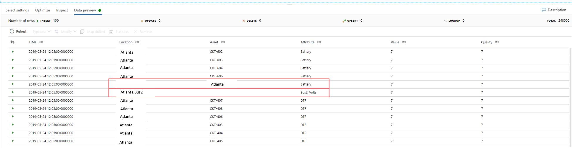

Here is what my data looks like once I use these expressions below to parse through the data. The expressions work fine except on a few case scenarios (highlighted in red). I've attempted using iif statements as well usecase(), but am not getting exactly what I'm wanting to see.

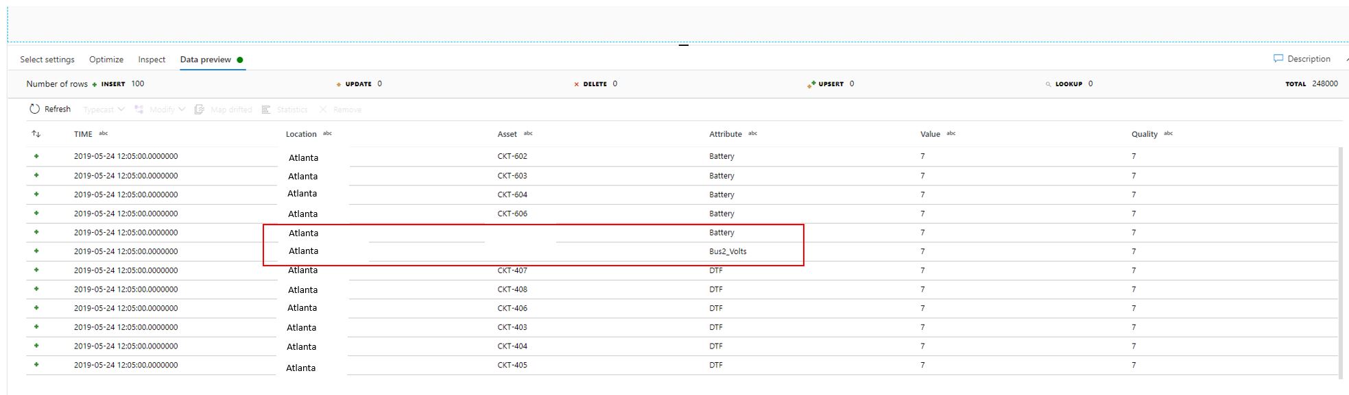

Here is what I would like to create using the expressions :
I'm thinking to catch these different records the location expression should include something along the lines of : if ResourceName shows a "." before a "" , then split at ".", else split at "". If you have any direction, I would really appreciate the help. Thank you.

  1. MarkKromer-MSFT 5,231 Reputation points Microsoft Employee Moderator
    2021-03-11T19:36:13.46+00:00
    Do this all in 1 single Derived Column:
    Step 1: Create a new local var like this: regexSplit(Resource,'\s|_|\.|-')
    Step 2: Location = :local1[1]
    Step 3: Asset = iif(size(:local1)<3,toString(null()),:local1[2])
    Step 4: Attribute = iif(size(:local1)<3,:local1[2],:local1[3])
