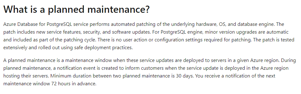

    This could have happened cause of the planned maintenance for the underlying resources for the Azure Database for Postgresql. Here is the document that explains the same.

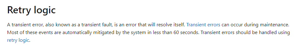

    1) Retry Logic

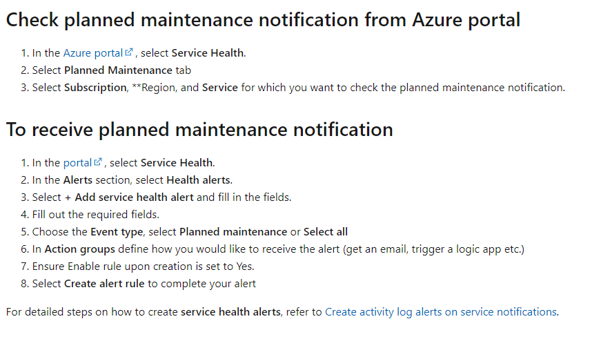

    2) Planned restart notification set up
