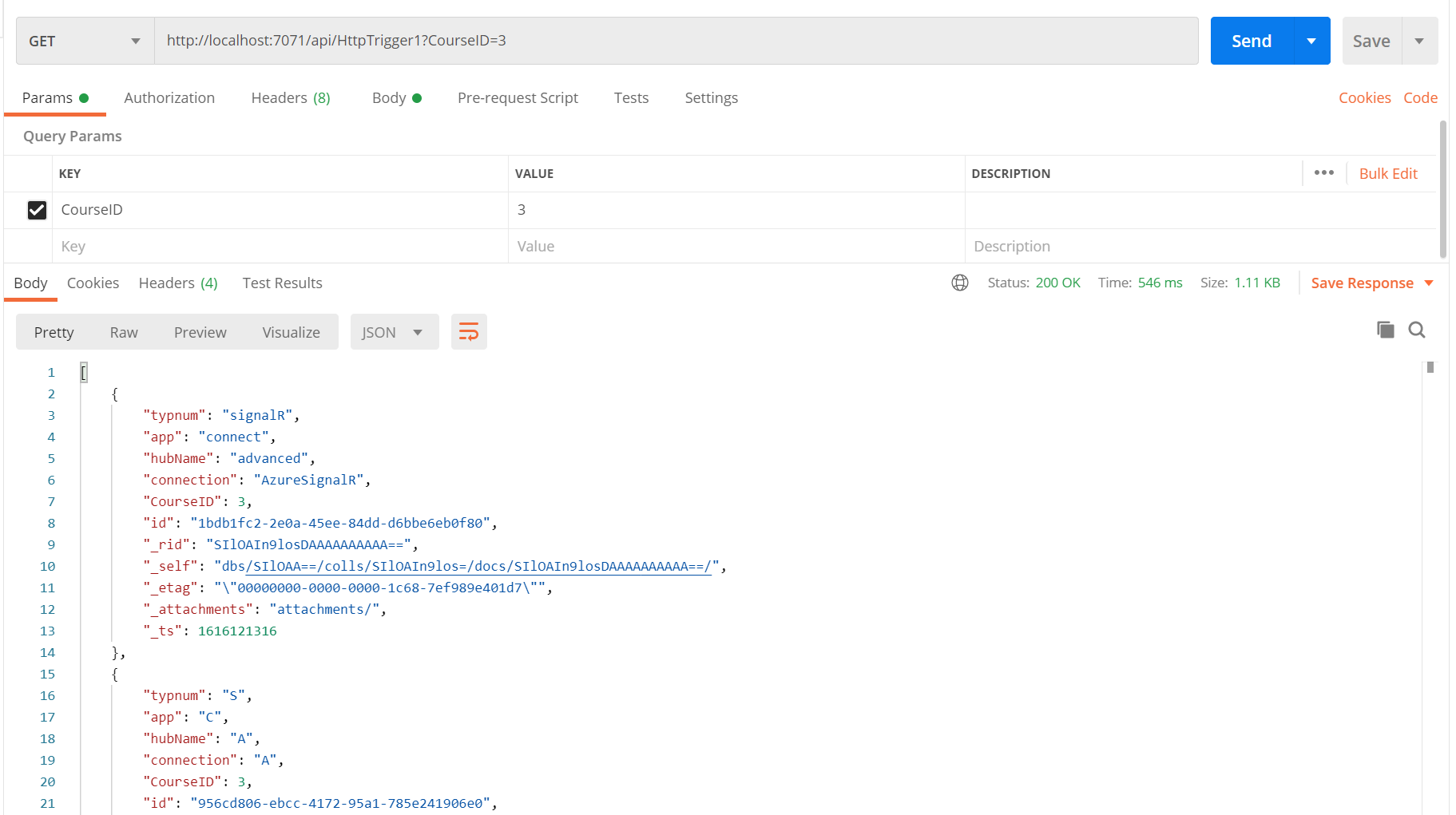

  1. I attempted to query Cosmos DB from the Microsoft Azure Storage Explorer and got a 200. Which implies my query was OK.
  2. I then attempted to use Azure Function with Cosmos input Binding. I got the results I wanted.
  3. Attempting to make the query dynamic has proved to be a challenge. Any Ideas?
I keep getting an empty list. 😭

  1. ChaitanyaNaykodi-MSFT 27,661 Reputation points Microsoft Employee Moderator
    2021-03-19T03:28:28.76+00:00
    Hello @Serge Nalishiwa , I think the issue is caused as your CourseID is of type INT, But in the query it is being passed as a string. Can you please modify the sqlQuery in your function.json as shown below.
    "sqlQuery": "SELECT * from c where c.CourseID = StringToNumber({CourseID})"
    It worked for me when I tried it out.
