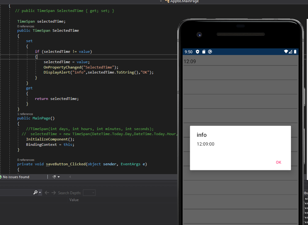

    You can use above custom timpicker directly in MVVM page. For example, I binding a value to time in TimePicker like following code.
       <TimePicker Time="{Binding SelectedTime}"></TimePicker>
    We can get the SelectedTime from custom TimePicker in the viewModel.
       TimeSpan selectedTime;
               public TimeSpan SelectedTime
                   set
                       if (selectedTime != value)
                           selectedTime = value;
                           OnPropertyChanged("SelectedTime");
                         //  DisplayAlert("info",selectedTime.ToString(),"OK");
                   get
                       return selectedTime;
    Here is running screenshot.
