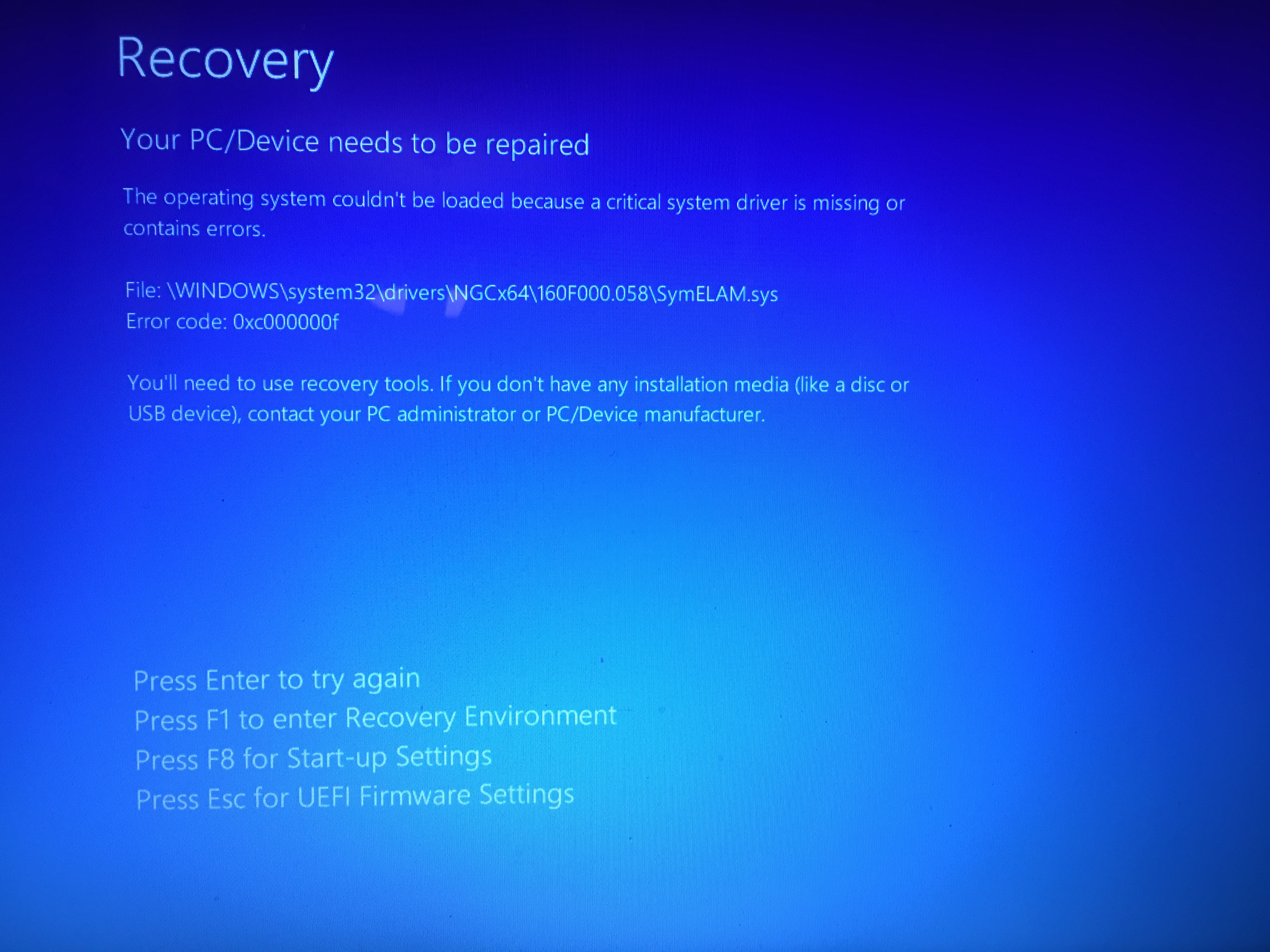

Started update today around 2pm, took about 5 hours to complete!
Rebooted the laptop, now comes up with a blue screen saying a driver is corrupt or missing and wont boot any further.
Only did the update because Microsoft might have fixed the issue with disk usage at 100% all the time, and now its broken completely.

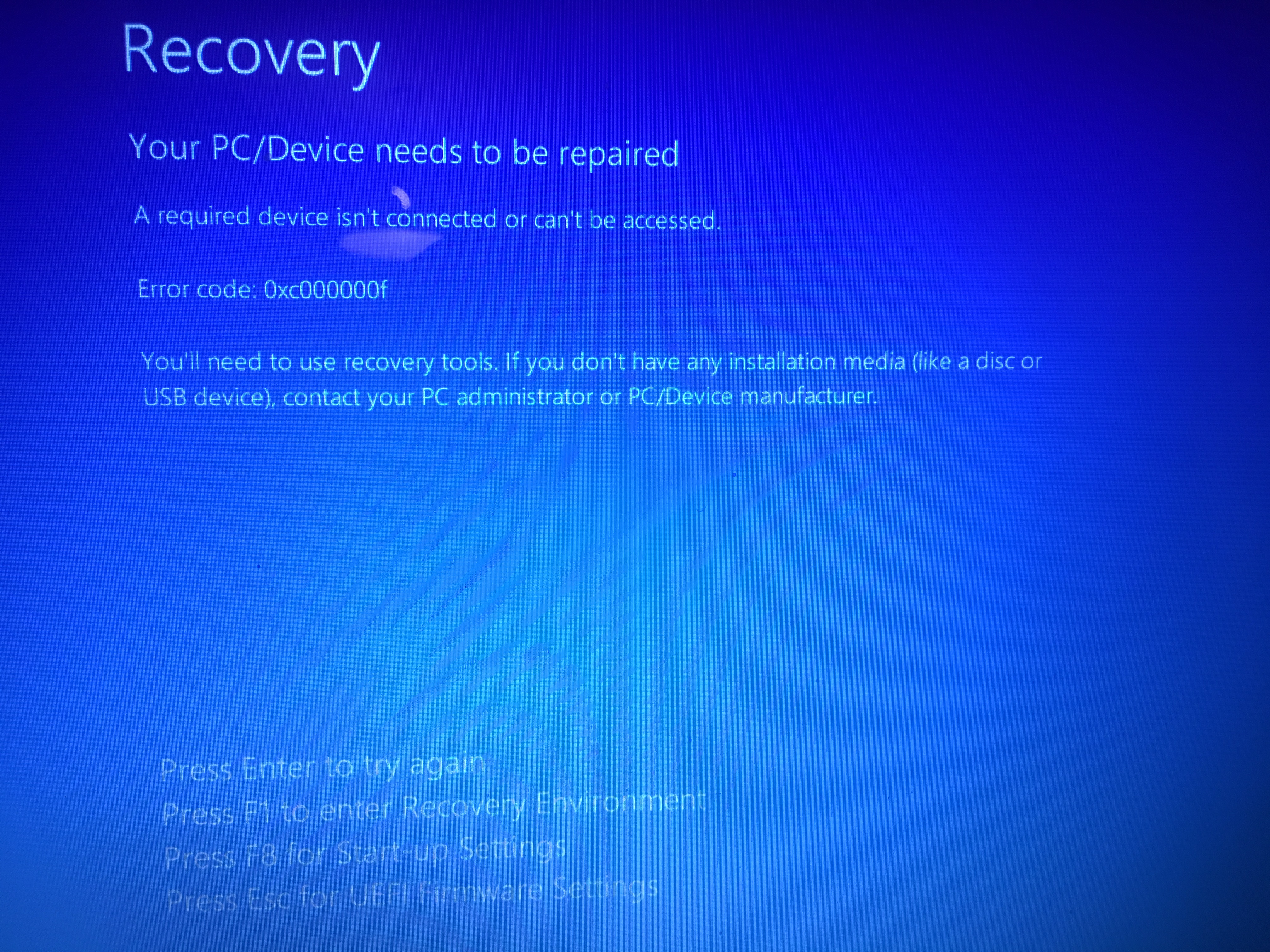

    2018-11-07T21:16:03+00:00
    If I press F1 I get this:
    2018-11-07T21:14:54+00:00
    On reboot i get this error. I assume I can replace this corrupt file?

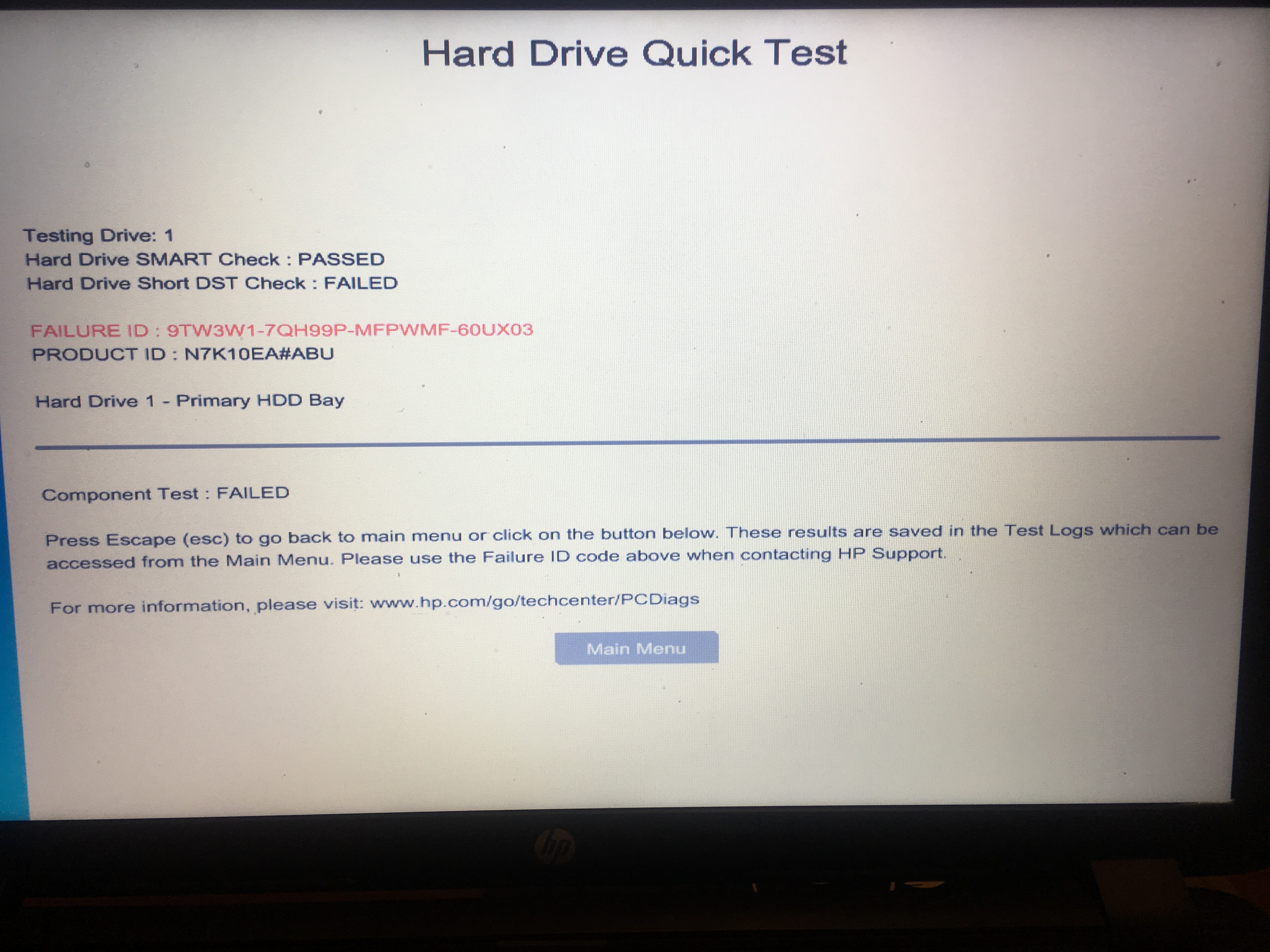

    You can confirm the HD failure by Testing the hard drive with diagnostics: https://www.lifewire.com/free-hard-drive-testin.... Best is Seatools bootable Long Test which works on all models:
    http://blog.nowherelan.com/2013/04/04/boot-seat....
    https://www.seagate.com/manuals/software/seatoo...
    Follow that up with a full Disk Check, from the Command Prompt if necessary: https://www.groovypost.com/howto/check-hard-dri...
    If the hard drive is failing I'd replace it with an SSD which is the best upgrade you can give your PC - lightning fast, better than a new higher end PC without one.
    Follow the included instructions or a video you find for your model via Google to swap it in and do this Clean Install which should get you past all difficulties as it has hundreds of thousands of others who have followed the steps in this link and never come back to report another problem: http://answers.microsoft.com/en-us/windows/wiki...
    Keep me posted.
    2018-11-07T21:04:51+00:00
    I have started the built in HP diagnostic tests, it fails this one:

    Hi Laurence. I'm Greg, an installation specialist and 9 year Windows MVP, here to help you.
    Here are steps to recover from failed Updates or Version Update install which causes Windows to fail to start:
    1. Try whichever method works here to get into Advanced Startup Options to run System Restore if this is a Windows Update, or Go Back to Old Version if this is a version update. https://www.tenforums.com/tutorials/2294-advanc.... Easiest is to restart or force shutdown the PC 3 times.
    If you are able to access System Restore or Go Back and it fails, skip to step 3.
    1. If necessary create bootable installation media to access the repair options if not accessible by any other method: http://windows.microsoft.com/en-us/windows-10/m...
    Boot media by powering up the PC while pressing the BIOS Boot Menu Key: https://www.sysnative.com/forums/hardware-tutor...
    You may need to enter BIOS/UEFI Setup to turn off Fast Boot if it won't allow the Boot Menu key to interrupt starting Windows: https://www.mydigitallife.net/comprehensive-lis...
    Choose UEFI version of media if offered, browse to second screen to Repair Your Computer link, then Advanced Troubleshoot options to run System Restore to a point before the problem began, or choose More Options to Go Back to Old Version if this was a version Update.
    If it rolls back then you can hide the Windows Updates and Version Upgrade responsible until they mature by installing and running immediately the Hide Updates tool: https://www.howtogeek.com/224471/how-to-prevent...
    1. If this fails try a Startup Repair, or go back to Troubleshoot Options on the previous screen to Reset your PC which will save your files while reinstalling Windows.
    2. If that fails you can use the booted media to Clean Install the latest version which should get you past all difficulties as it has hundreds of thousands of others who have followed the steps in this link and never come back to report another problem: http://answers.microsoft.com/en-us/windows/wiki... The link compiles the best possible install of Windows 10 that will stay that way as long as you stick with the tools and methods given.
    There is a step to rescue files from the same bootable media: http://answers.microsoft.com/en-us/windows/wiki...
    Make sure during the booted install to follow the illustrated steps to delete all partitions down to Unallocated Space to get it cleanest, then click Next to let it auto-create the needed partitions, format them and begin install - this makes it foolproof.
    The media provided for the Clean Install is Version 1803 and normally the problems go away with the Clean Install, however if they don't you can find earlier version media to use here: https://tb.rg-adguard.net/public.php
    Burn to DVD or create bootable 8+gb flash stick installer using this tool installed to Windows: https://www.microsoft.com/en-us/download/detail...
    Then once you're back in Windows 10, you can block the problem Windows or Version Update using one of these methods: https://www.howtogeek.com/224471/how-to-prevent...
    Feel free to ask back any questions and let us know how it goes. I'll keep working with you until it's resolved.
