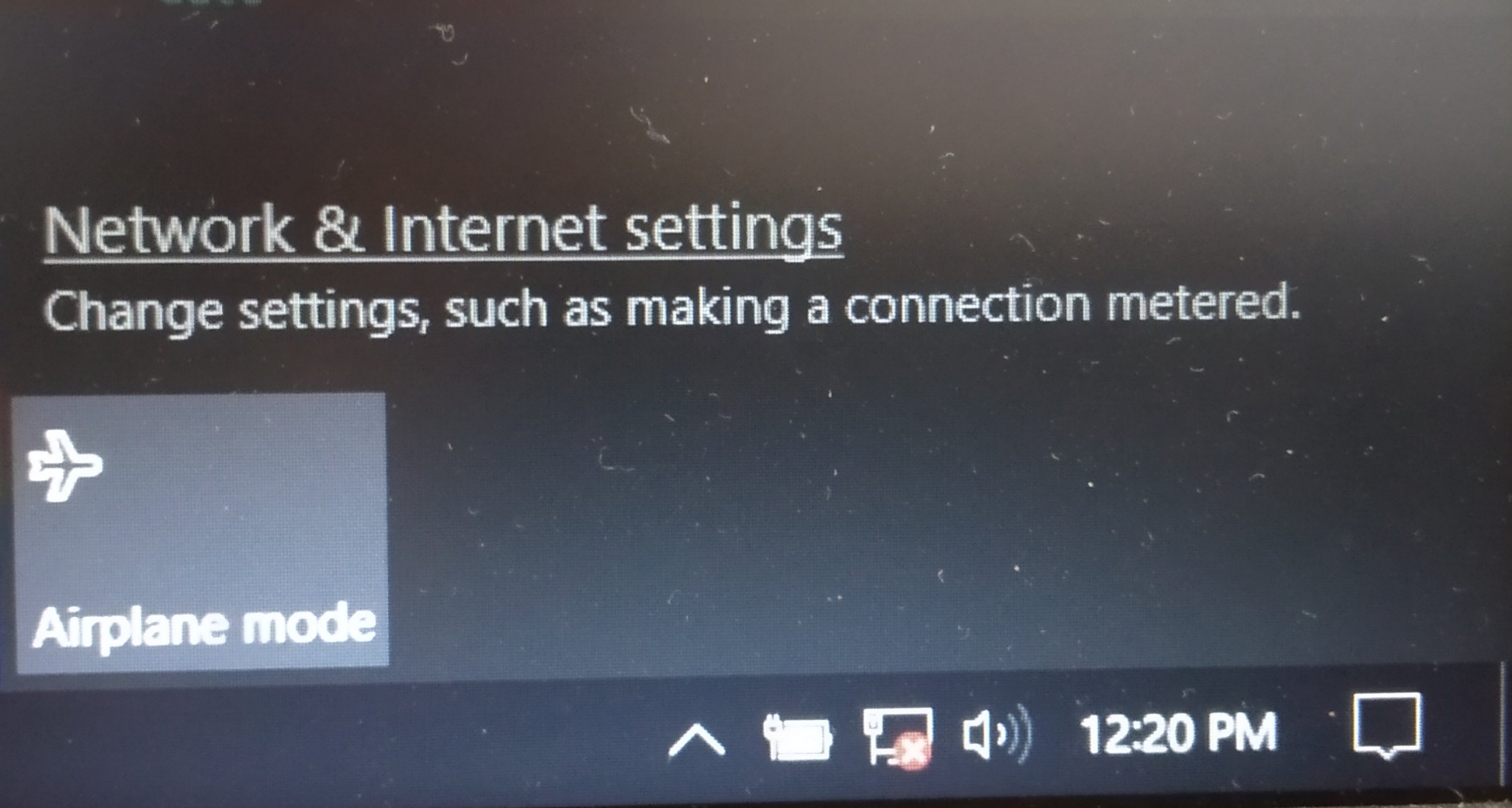

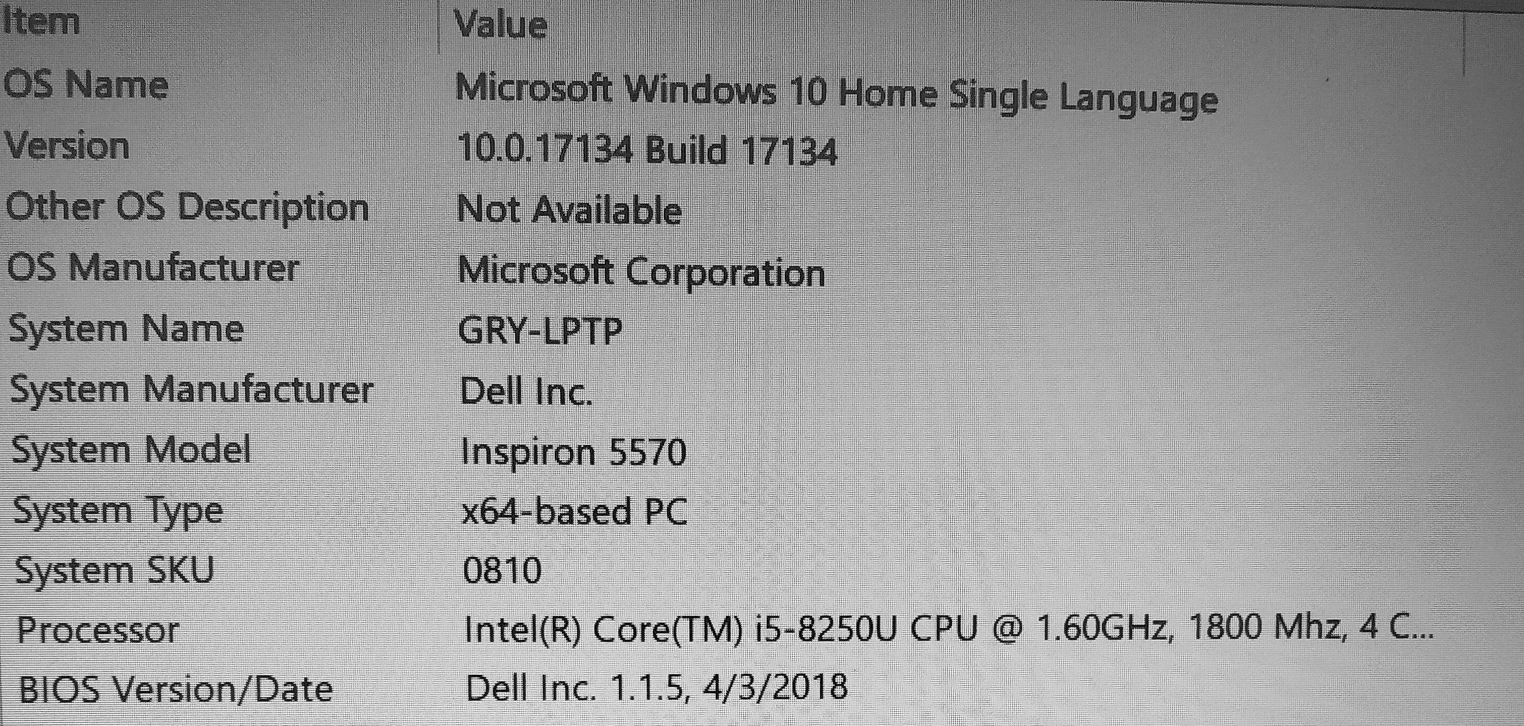

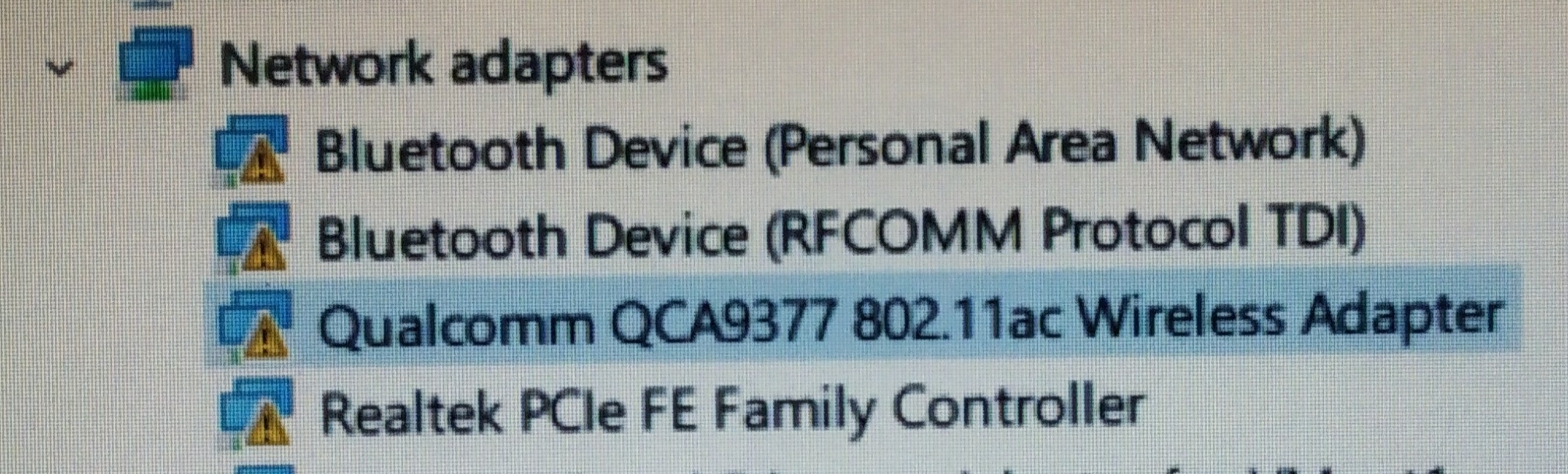

My computer was working fine with internet access, while updating the network drivers I got disconnected from my home wifi but the update failed in the end. I know people talked about this and found that they had third party VPN running but  I don't have any VPN running. I tried using window's troubleshoot but it couldn't identify the problem, uninstall and restart, cmd lines, network reset, nothing worked. Here are the pics.

    Hi Brian,
    Thank you for writing to Microsoft Community Forums.
    I appreciate your efforts to work on this issue.
    Please reply with the following details to assist you in a better way:
    • How were you updating the drivers?
    • What is the make and model of your computer?
    • Which build version of Windows is installed on the computer?
    As you have already tried uninstalling the drivers and restarting the computer, I suggest you to download the drivers from the Manufacturer’s website and install them.

    I suggest you to uninstall the driver from Device manager and install the drivers from the Dell website. Please refer the steps mentioned below to uninstall and reinstall the driver:
    1. Press and hold the Windows + X key on the keyboard.
    2. Select Device manager.
    3. In Device manager, expand Network Adapters.
    4. Right click on Qualcomm QCA9377 802.11ac Wireless Adapter and select uninstall.
    5. You will receive a prompt; make sure you check the box for Delete the driver software.
    6. After uninstalling the driver, download the drivers from Inspiron 5570 and install them.
    7. Restart the computer.
    Hope it helps.
    Please reply with the status of the issue, we will be glad to help you further.
    Nikhar Khare
    Microsoft Community - Moderator
    2018-11-30T11:45:00+00:00
    Hi, it didn't work, still the same error. I installed driver from Device manager and opened the installShield wizard, chose remove, then I opened it again to reinstall everything. It said The update installer operation is successful. After that, I restarted pc and nothing changed.
