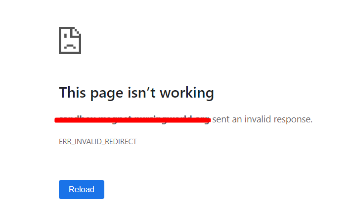

Mahesh Patil 0 Reputation points
2023-01-12T11:28:40.81+00:00 I tried the solution provided in link. after implementation now URL is not changing but getting below error:
