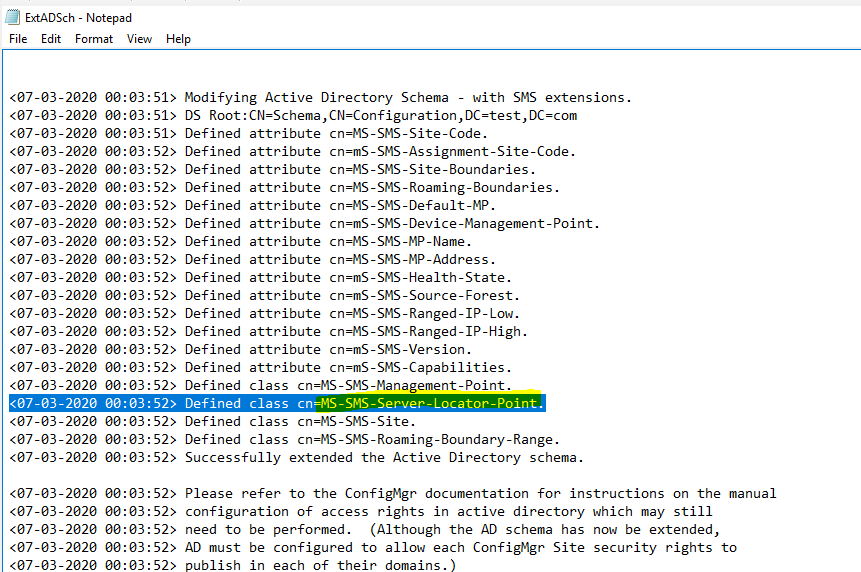

  3. Simon Ren-MSFT 40,346 Reputation points Microsoft External Staff
    2021-03-22T05:56:28.007+00:00
    Thanks for your reply.
    If you have you extended your AD schema when installed SCCM site, yes, the MS-SMS-Server-Locator-Point class will add to your AD schema, as shown below:
    However, the SMSSLP attribute is not shown in my lab. Please help check if the SMSSLP property exists in your SCCM site properties under CN=System Management, CN=System, DC=yourdomain.
    Thanks for your time.
