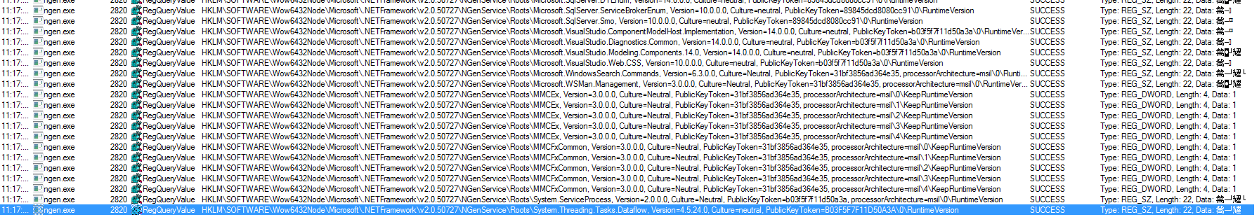

    I've scanned my system with system file checker and dism but both didn't report any significant errors. So I assume only OPTION THREE is valid now.
    After some time digging with ProcessMonitor I've found the root cause of this creepy ngen behaviour. Registry key HKLM\Software\Wow6432Node\Microsoft.NETFramework\v2.0.50727\NGenService\Roots has been corrupted. It contains keys which are not normally processed by regedit tool but ngen still enumerates values from them:
    Do you know any good implementation of registry reader/writer which doesn't relly on registry win32 api or I need manually navigate through registry HBINS trying to fix them?
