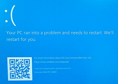

I was updating BIOS (to 1.58) on my ThinkPad T470 yesterday, it went fine and the system went into reboot. I'm not sure, but there might have been some Windows updated scheduled to be applied at reboot as well. The OS (Windows 10) couldn't load - BSOD with with Stop Code 'REGISTRY ERROR'.

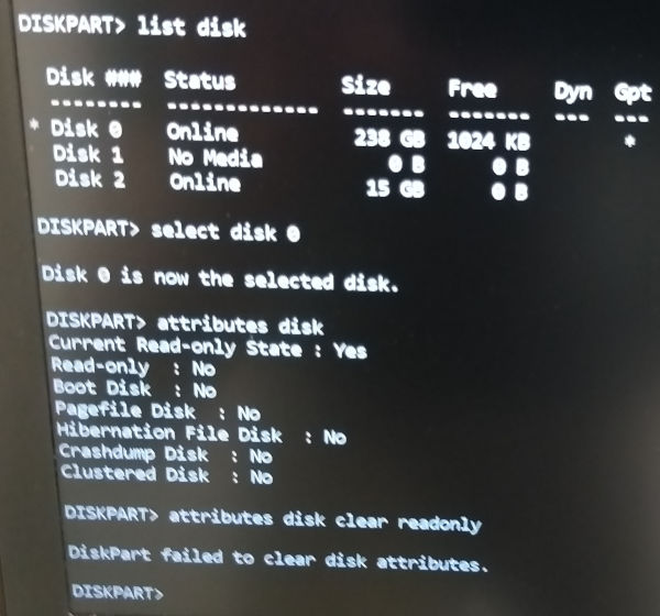

    Some additional info on the issue.
    This is what I get using Diskpart from the Windows Recovery Media:
    Current Read-only State: Yes
    The command
    DISKPART> attributes disk clear readonly
    returns
    DiskPart failed to clear disk attributes

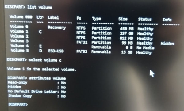

    Screenshot of partitions:
