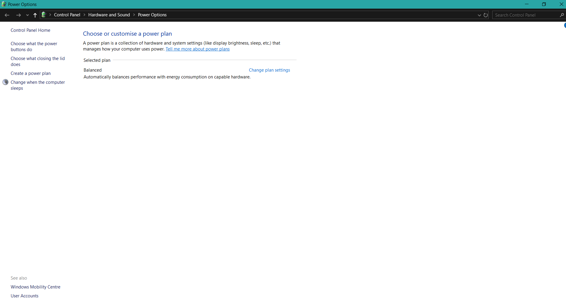

After upgrading to version 1903 the only Power Option available is Balanced. Thats it - No High Performance , .
How to get them back , ?
Tried various methods via Command Prompt and Powershell to which they both accepted the commands but still no other Power Options.
Or they now not available under 1903. ?

    Hi thanks for that- the only option that DID WORK was changing the CsEnabled  to 0.
    Many thanks
