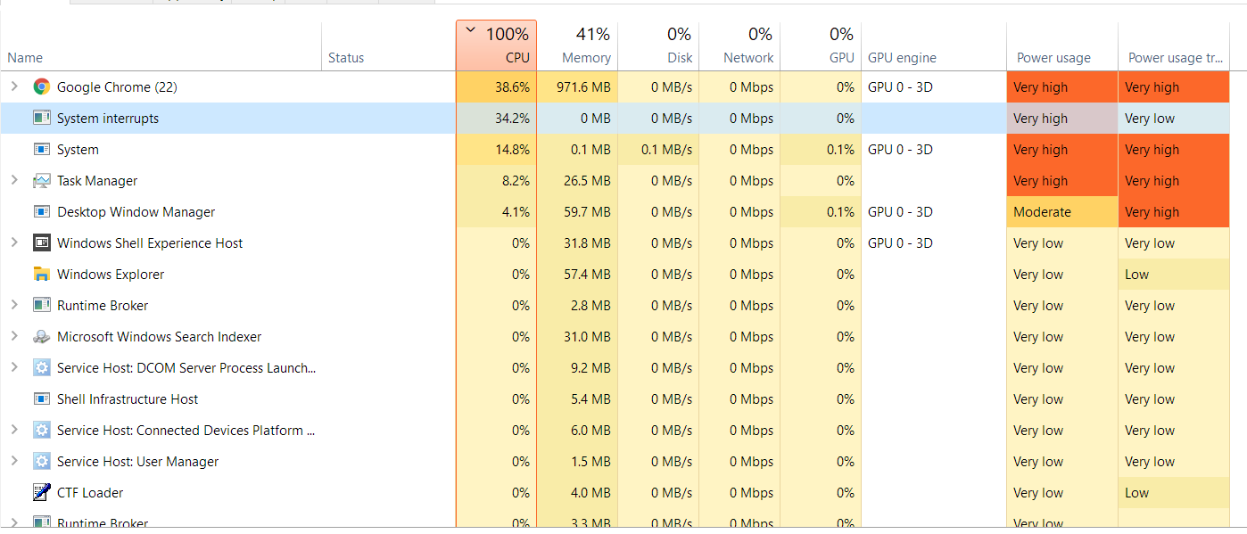

The culprits in the Task Manager appear to be "System", "System Interrupts" and "Desktop Window Manager".  See this screenshot:
The CPU usage of these three tasks jumps up and down between 30% and 0%, but the total CPU usage is always reported as 100%.

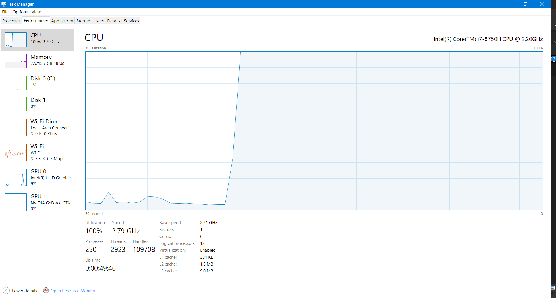

Here is a screenshot from that:
Where my mouse is (around 6 seconds in) is when I plugged in my laptop. There is a small spike in System (4) processes, but those go back down. When looking at task manager during this time, CPU usage is at 100%, but this performance trace does not report the same thing as seen here:

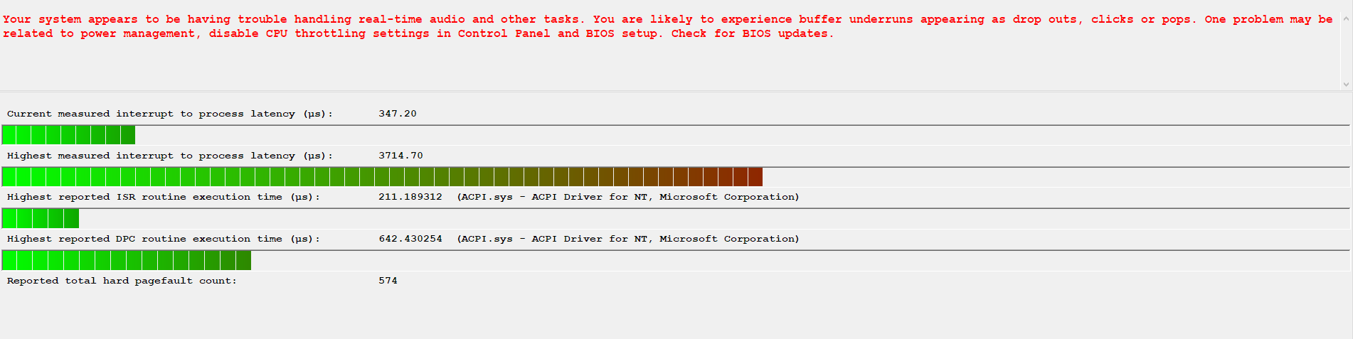

    2020-01-28T15:57:03+00:00
    Thanks Igor!
    I checked out LatencyMon and have been getting reports similar to this:
    High interrupt to process latency and high DPC routine execution time.
    What would you suggest next? I have been going through and disabling various drivers without success.
  3. Igor Leyko 108.3K Reputation points Independent Advisor
    2020-01-28T16:03:49+00:00
    Check for BIOS updates. clean internal cooling system from dust.
