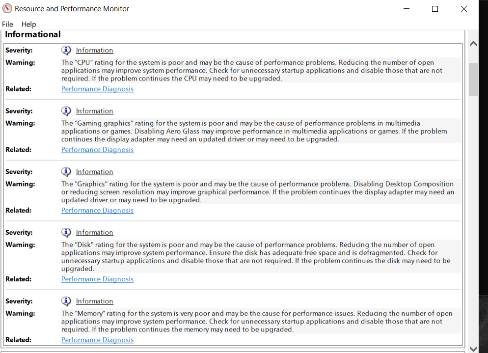

I am having this weird situation where, when I connect my laptop to power the performance drops down significantly. Games like Horizon 4 which work absolutely fine on battery, start lagging as soon as I connect it to power (the car turns/accelerates seconds after I press the keys).
Other normal tasks seem to work fine, browsing, Netflix etc.
I just reset my Laptop yesterday hoping that it would solve the issue but it didn't. Also I have enabled high performance mode and game mode.
None of this seems to work.
I am attaching a screenshot of my performance monitor report which ran when I connected my laptop to power.
The PC was completely idle and no apps were running in the background when I started the test.
Everything works fine on battery the problem only kicks in when I connect it to the external power brick.

    Thank you for your reply. I use
    1. Dell Inspiron 15 7000 gaming laptop
    2. The stock adapter provided with it.
         Power: 130W
          Input at: AC 240V @ 2.5A
         Output at: 19.5V @ 6.7A
    I might be wrong but if it were a hardware issue wouldn't I have the same problem regardless if I plug-in or use the battery power?
