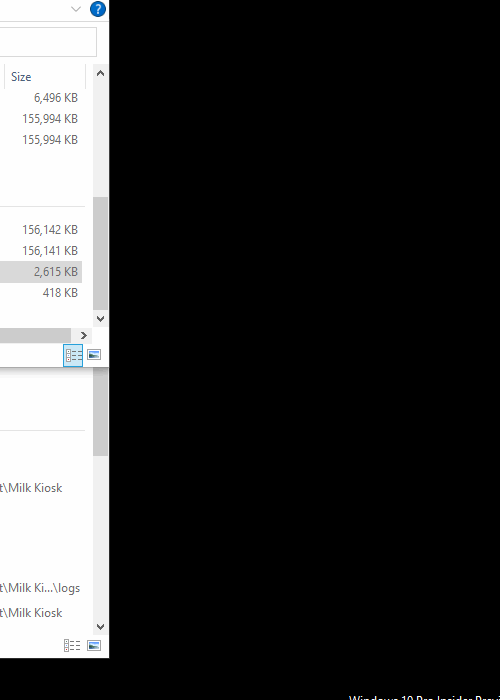

I managed to reproduce the issue with different application. I actually wanted to use it just to record how the keyboard behaves with our app, but turned out that one had the same problem. You can get one for tests here: https://www.screentogif.com
I also attach below gif to present the problem (running screen to gif application).
Tablet is running in normal mode, not a tablet mode and explorer.exe is started.
You can see two keyboards popping up (on the side I've selected input box at the moment)
The first keyboard can be dismissed. But then you can observe that I've clicked close button on the dark one a couple of times, but it does nothing. To get rid of it I have to click on input box one more time. Then the close button closed the keyboard as expected.
