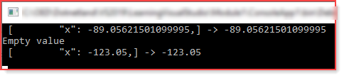

  1. Karen Payne MVP 35,596 Reputation points Volunteer Moderator
    2021-03-25T17:48:27.283+00:00
    Try the following
    var someValue = " [        \"x\": -89.05621501099995,]";
    var result = Regex.Replace(someValue, "[^0-9.-]", "");
    Array example
    string[] values = {" [        \"x\": -89.05621501099995,]", "", " [        \"x\": -123.05,]" };
    foreach (var value in values)
        var fixedValue = Regex.Replace(value, "[^0-9.-]", "");
        Console.WriteLine(string.IsNullOrWhiteSpace(fixedValue) ? "Empty value" : $"{value} -> {fixedValue}");
