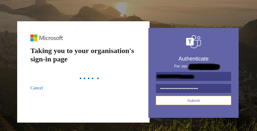

Unable to click the submit button when trying to sign in as my workplace uses SSO.

  1. Andrew Rakowski 111 Reputation points
    2019-12-14T00:26:23.543+00:00
    I had a similar problem, but clicking on "submit" brought up a request to open my Gnome keyring. I have been using KDE for years, and didn't remember a password to that keyring. I ended up going into "~/.gnome2/keyrings" and mv'ing the existing *.keyring and *.keystore files out of that directory. At that point, I got a request that an app wanted to create a new keyring entry, and I allowed it. That got my login to actually continue.
    I'm not sure why it wanted to put my login/password in a keyring (if that's what it was doing), but getting rid of my old keyring files allowed me to move forward. There might just be a pop-up that popped under requesting a keyring unlock - and if you know the password, that might get you moving again. Cheers. [AER]

  3. ThimoE 6 Reputation points
    2020-01-08T14:13:23.14+00:00
    I experienced the same issue due to a faulty proxy setting (found via wireshark).
    For me, MS Teams picks up the KDE Proxy settings when running in a KDE environment (which makes sense but still is somehow an exception).
    Change it in System Settings/Network/Settings/Proxy
    It seems, MS Teams also accepts the chromium-style cmd-line options, like --proxy-auto-detect, --proxy-pac-url=URL, --no-proxy-server and --proxy-server=host:port
    If the above did not work and you use a Kerberos enabled Linux machine the following might lead to success:
    First, check if you have a TGT using klist command
    Second, you probably need to start MS Teams with the cmd-line option --auth-server-whitelist=.example.com
    In our company, I can not use a fixed proxy setting since the proxy can not access the ADFS server - thus I need to use the proxy auto configuration or a combination of --proxy-server=host:port and --proxy-bypass-list=*.example.com

  5. Marcin 1 Reputation point
    2021-08-26T10:32:01.737+00:00
    Same issue here on Arch/Manajro with xfce. It was caused by missing gnome-keyring. Once I installed it, it worked:
    pacman -S gnome-keyring
