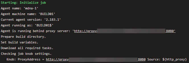

I have a YAML pipeline using the task AzureRmWebAppDeployment@4. It is configured to use MSDeploy to an Azure slot.
This pipeline is run using on-premise agents behind a corporate proxy. The agents are run under the NETWORK_SERVICE user.
However, I'm getting timeouts. MSDeploy is not using any proxy configuration on our server.
1) There is a user specific proxy in iexplore.exe
2) I've added a proxy setting under MSDeploy.exe.config
You can see that msdeploy is trying to connect directly to Azure instead of going through the proxy.
What is the best way to set up a proxy for msdeploy?
