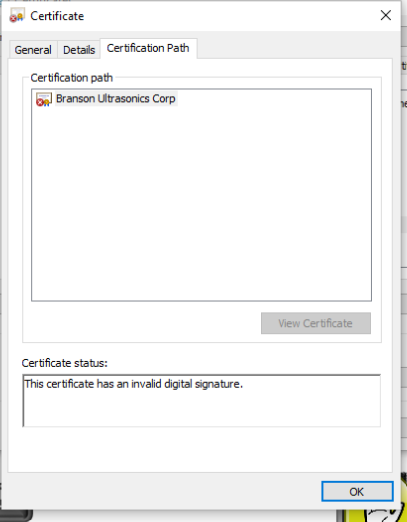

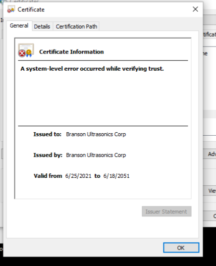

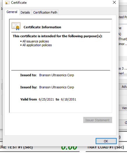

  3. Ananymous 0 Reputation points
    2026-03-19T15:14:09.6133333+00:00
    I am having Similar issue with one of our PC running on windows 10 pro. This issue persists with only one specific user profile on active domain but when i log in as a different user the same cert gets approved. Could anyone help me on this if they already figured out what causing this issue
    image (2)
    image (1)
    But as a different user
    image (3)
