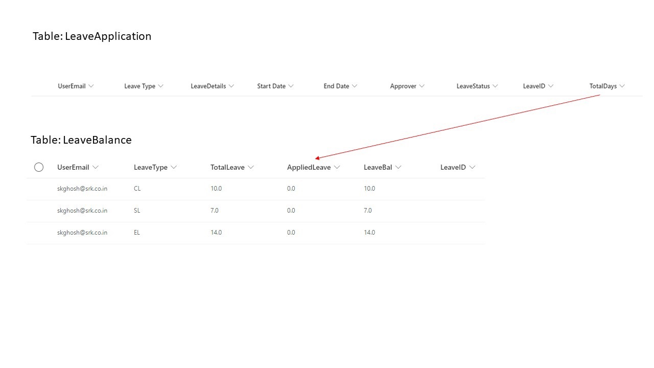

  4. Santosh K Ghosh 0 Reputation points
    2023-06-20T05:58:57.0466667+00:00
    I do have similar problem, but I want once leave is approved by approver using email, a flow will run to update another sharepoint list that store the leave balance. Prompt advice and help would be appreciated.
