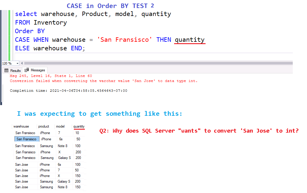

2
select warehouse, Product, model, quantity
FROM Inventory
Order BY
CASE WHEN warehouse = 'San Fransisco' THEN quantity
ELSE warehouse END;

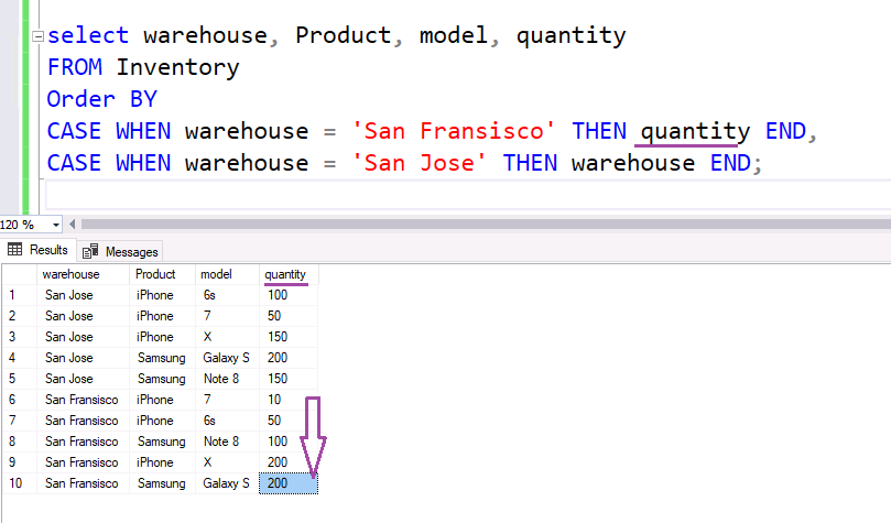

As far as I understand this query -
FROM Inventory
Order BY
CASE WHEN warehouse = 'San Fransisco' THEN quantity END,
CASE WHEN warehouse = 'San Jose' THEN warehouse END;
  • is the same as the query with
    "CASE WHEN warehouse = 'San Fransisco' THEN quantity
    ELSE warehouse END"
    and it does work:

    You got the 'Conversion failed when converting the varchar value 'San Jose' to data type int' error due to the quantity and warehouse had different date types. One is integer and the other one is varchar.

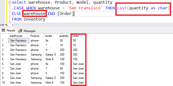

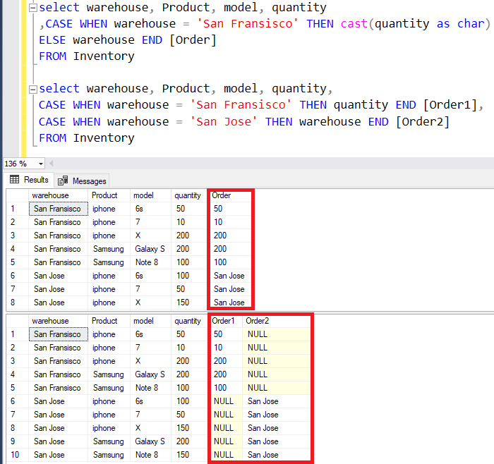

    They are not the same. They had different columns in the output as below:
    Please refer below which could be the same:
    FROM Inventory
    order by CASE WHEN warehouse = 'San Fransisco' THEN cast(quantity as char)
    ELSE warehouse END
    FROM Inventory
    order by

  2. Michael Taylor 60,326 Reputation points
    2021-04-06T15:43:45.71+00:00
    Are they the same - no. Do they do the same thing for your specific query - possibly. In your first query you are have 2 different order by clauses.
    Order BY
    The first order by orders by quantity when warehouse is SF otherwise it does nothing. Then for those that have the same first value (basically SF vs everyone else) then it orders by warehouse if SJ otherwise it does nothing. Without testing I suspect you'll see SF rows ordered by quantity first and then SJ rows ordered by warehouse and then everything else.
    In the second query you have a single order by.
    ELSE warehouse END"
    The rows are ordered by either quantity or warehouse depending upon the warehouse value. Since quantity and warehouse are both used the single ordering will order all rows using the textual value of one of two columns. If numbers sort higher in the collation used by the DB then SF quantities will appear first otherwise the warehouse will sort first and the SF quantities last.
  3. Mikhail Firsov 1,881 Reputation points
    2021-04-06T19:32:20.18+00:00
    "Are they the same - no. Do they do the same thing for your specific query - possibly. ", - yes, I agree, but why this
    ELSE warehouse END"
    returns the the error (please see q03.png)???

    When it comes to
    ELSE warehouse END
    This fails because you are mixing data types. SQL is a statically typed language, and a CASE expression always return the one and same data type. When two types in SQL Server meet, SQL Server applies a strict precedence list, and in this list, varchar ranks fairly low, only binary trails behind. integer is higher on the list, so thus SQL Server attempts to convert the warehouse name to number, and this ends in tears.
