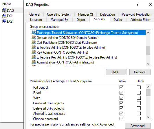

    You could give it full access to the Exchange Trusted Subsystem group, no need to add as a member,

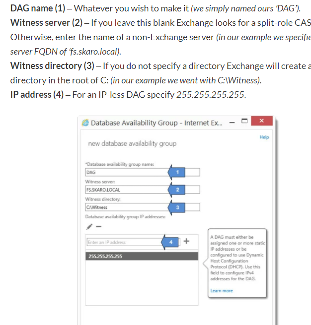

    I would recreate the DAG myself and not create the CNO. its not needed unless you have a backup software or something similar that requires it.
    Much easier to manage it then!
    https://supertekboy.com/2015/06/30/create-an-ip-less-dag-no-administrative-access-point/

    You could try creating the CNO and give it a full control permission of Exchange Trusted Subsystem and your Exchange servers then disable it to add servers to the DAG.
    Add the member servers first and then:
    Read this article for more information: Prestage cluster computer objects in Active Directory Domain Services
    Recreating a DAG is not a hard work, before removing the DAG, you should remove all member servers. In your case, you can directly remove it with no efforts.
