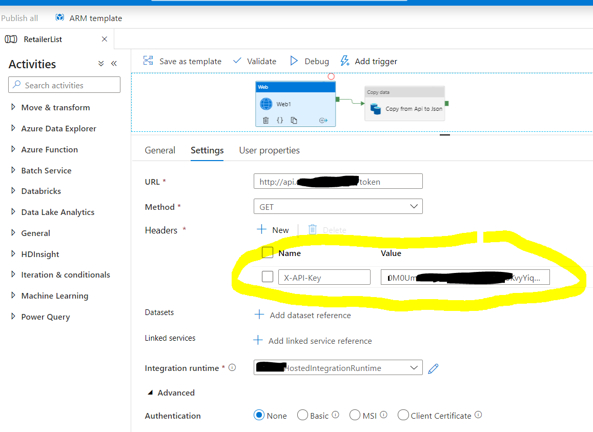

I have a pipeline which first takes token from a rest call (web activity) and then use this token to get data from rest API (copy activity).
To get a token I have to provide an API-key. Is there a way not to expose this API-key in a pipeline? Or maybe build this pipeline another, more secured way? Exposing it for other data factory users gives them oportunity to catch the token and later access data.

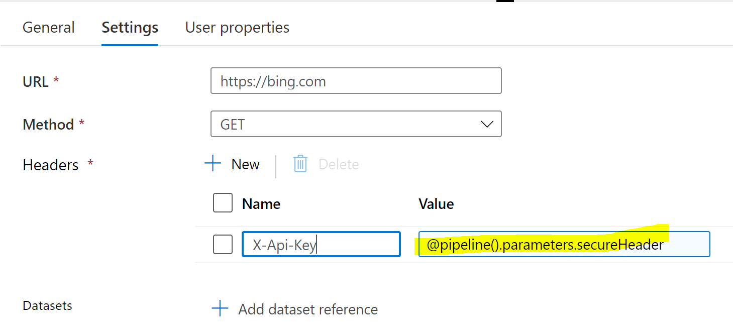

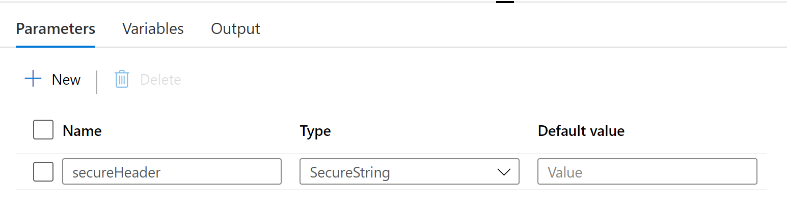

    There is a parameter type called SecureString. Instead of placing the value directly in the Copy Activity header, place it in a parameter of type SecureString. Then in the Copy Activity header, refer to it. There is a complication, but first to show you how its done.
    @pipeline().parameters.secureHeader

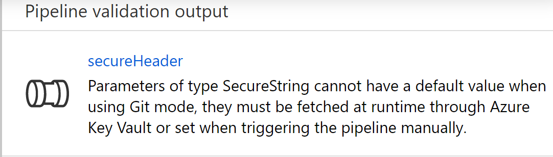

    The complication is when using Git Mode you may see an error like below, telling you SecureString cannot have a default value.

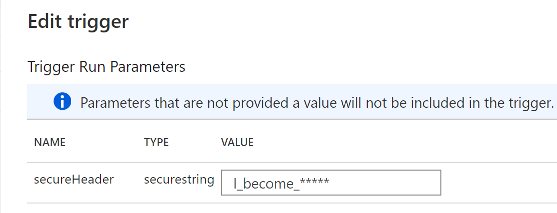

    The solution is to leave the value in the pipeline blank, but instead give the value when you make a trigger. The trigger can store and hide the key. The trigger then gives the key to the pipeline parameter, which gives it to the web activity header.
