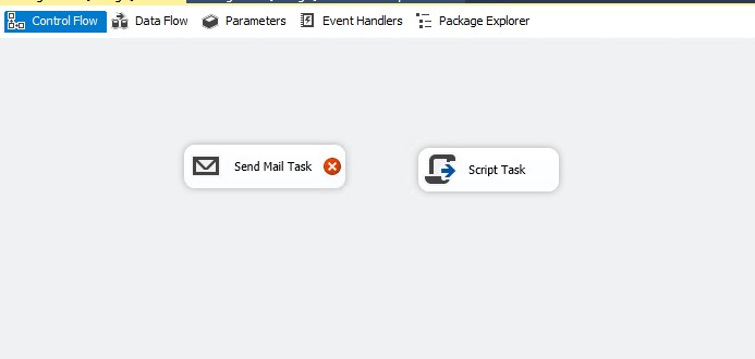

    Not fully understand your meaning.
    Could you please share the tasks in control flow so that we could get details about the issue?
    Such like below:
    Also you may refer integration-services-ssis-event-handlers for details.
