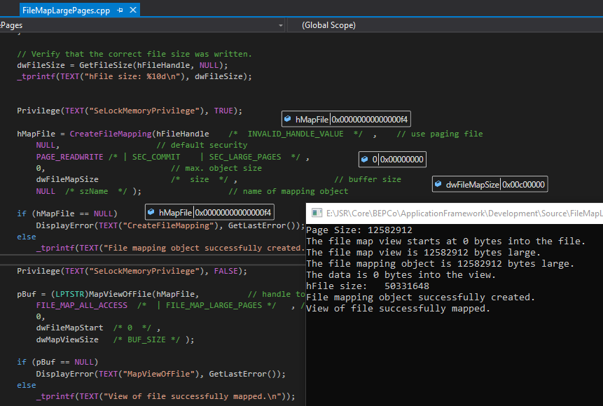

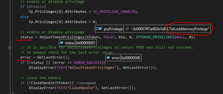

on a windows 10 version 1909 box with 48GB of memory, the createfilemapping() for a size of 0x200000 returns error 1450 as shown below
the privilege "SeLockMemoryPrivilege" is successfully enabled in the process token.
any suggestions/experience with such would be appreciated;
thanks you;

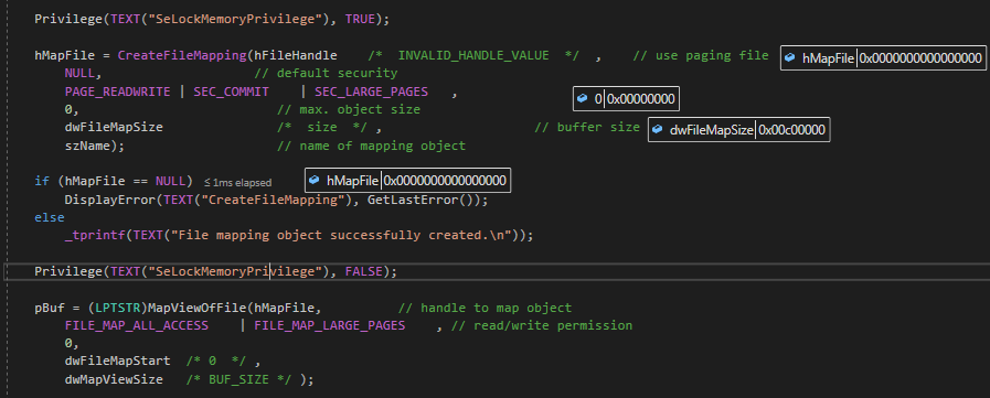

  1. jay rhoades 6 Reputation points
    2021-04-13T20:22:43.627+00:00
    here is attached txt (cpp) mainline that when put into a visual studio c++ console app will represent this ongoing discussion;
    this in lieu of posting a zip of the console app that with intellisense browse db is just way too big....
    if anyone has any insights into why using map_use_large_pages on specify size of 6 * GETLARGEPAGEMINIMUM results in 1450
    on windows 10 version 1909 box with 48GB of memory, baffles me;
    kind regards; @David Lowndes
    jsr;

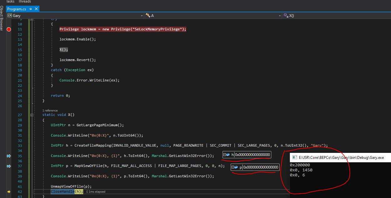

    One my system, I can allocate 6000 × GetLargePageMinimum() without error but 7000 × GetLargePageMinimum() fails with error 1450, so ERROR_NO_SYSTEM_RESOURCES/STATUS_INSUFFICIENT_RESOURCES seems sometimes to be an accurate description of the problem...

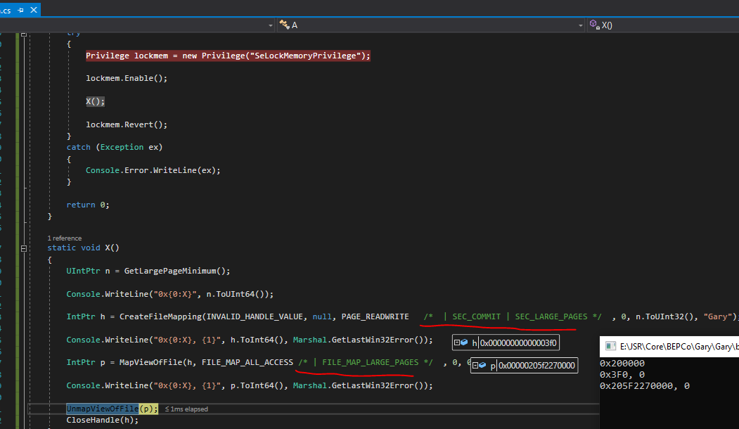

  3. Gary Nebbett 6,216 Reputation points
    2021-04-14T19:44:52.7+00:00
    Hello @jay rhoades ,
    Can you try compiling and running this program and then reporting what it shows? Success would look something like this:
    0x200000
    0xD8, 0
    0x1B000000, 0
    I checked that large page(s) were actually used and it seems that they are:
    0: kd> !vad 1B000000
    VAD Level Start End Commit
    ffffce8206e94b60 6 1b000 1b1ff 0 Mapped LargePag READWRITE Pagefile section, shared commit 0x200
    The program can be compiled by just invoking the command "%SystemRoot%\Microsoft.NET\Framework64\v4.0.30319\csc" with the name of the file containing the saved program text. You can add the "-platform:x64" option to the compilation if you want but the default (anycpu) should be OK too if there is nothing unusual about your environment.
    Gary

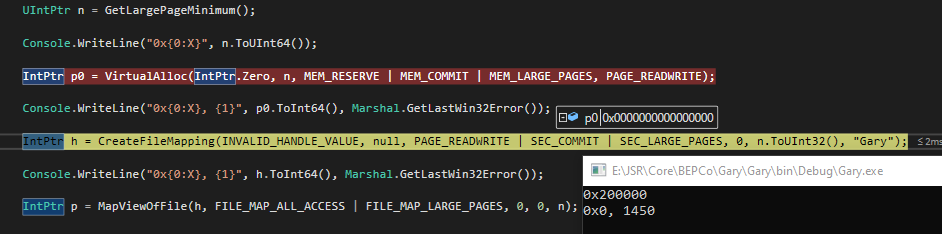

  4. Gary Nebbett 6,216 Reputation points
    2021-04-15T15:42:20.923+00:00
    As a first step, let's just try a VirtualAlloc with MEM_LARGE_PAGES and check whether that works (code below).
    Gary
